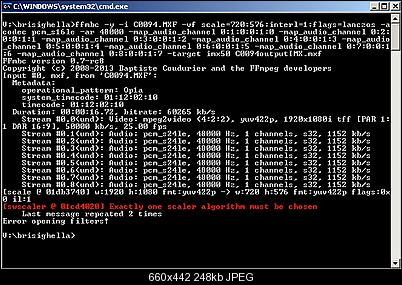

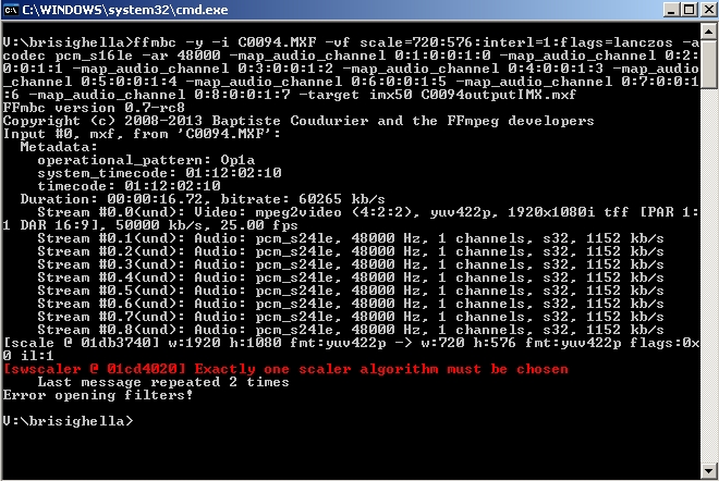

  13. I have try over another HD file (C0094.mxf) but it is the same, strangely I get an error using
    ffmbc -y -i C0094.MXF -vf scale=720:576:interl=1:flags=lanczos -acodec pcm_s16le -ar 48000 -map_audio_channel 0:1:0:0:1:0 -map_audio_channel 0:2:0:0:1:1 -map_audio_channel 0:3:0:0:1:2 -map_audio_channel 0:4:0:0:1:3 -map_audio_channel 0:5:0:0:1:4 -map_audio_channel 0:6:0:0:1:5 -map_audio_channel 0:7:0:0:1:6 -map_audio_channel 0:8:0:0:1:7 -target imx50 C0094outputIMX.mxf
    maybe a sintax error?
  14. -sws_flags lanczos

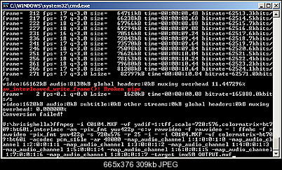

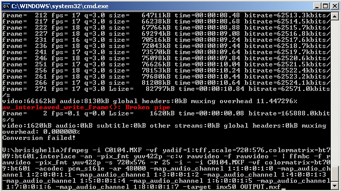

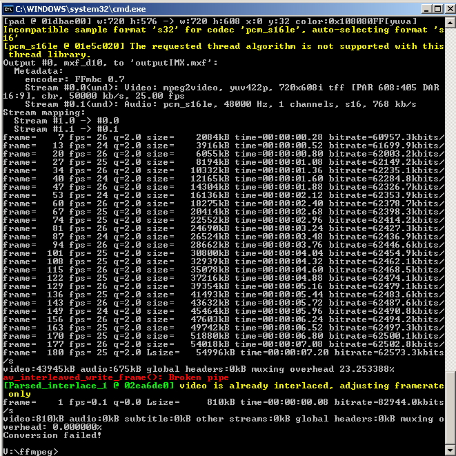

  27. Now audio appear but I see persist the vibrating problem
    and a "broken pipe" at the end of encoding
    the colormatrix line is doubled, however also with this, the problem of vibrating remains (and also the broken pipe error)
    ffmpeg -i C0104.MXF -vf yadif=1:tff,scale=720:576,colormatrix=bt709:bt601,interlace -an -pix_fmt yuv422p -c:v rawvideo -f rawvideo - | ffmbc -f rawvideo -pix_fmt yuv422p -s 720x576 -r 25 -i - -i C0104.MXF -acodec pcm_s16le -ar 48000 -map_audio_channel 1:1:0:0:1:0 -map_audio_channel 1:2:0:0:1:1 -map_audio_channel 1:3:0:0:1:2 -map_audio_channel 1:4:0:0:1:3 -map_audio_channel 1:5:0:0:1:4 -map_audio_channel 1:6:0:0:1:5 -map_audio_channel 1:7:0:0:1:6 -map_audio_channel 1:8:0:0:1:7 -target imx50 OUTPUT.mxf
    However the ffmpeg don't vibrate, seems ok:
    V:\brisighella>ffmpeg -i C0104.MXF -vf yadif=1:tff,scale=720:576,colormatrix=bt709:bt601,interlace -pix_fmt uyvy422 -c:v rawvideo -an outputavi.avi
  28. For some reason, the colormatrix works alone with ffmpeg, but not when piped through. I think there is a double conversion. If you leave it for ffmbc, not for ffmpeg, the colors are correct (ie. erase the 1st colormatrix instance with ffmpeg) . If you use only colormatrix ffmpeg through the pipe, colors are wrong
    The broken pipe message is a false alarm; it's because it doesn't know which video you are applying the filter to. Add -map 0:0 after the ffmbc inputs to specify that you are using the piped video and it won't complain
