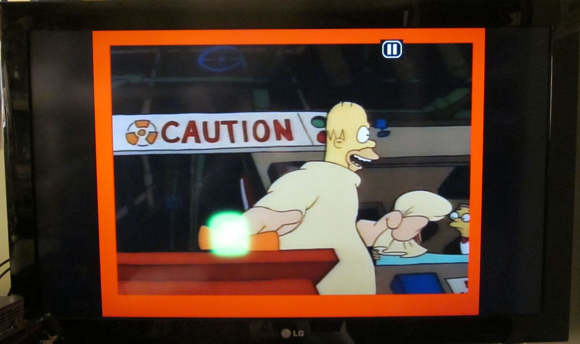

    You could use the 'subpic' method of placing a frame around the image - no re-encoding, just re-muxing.
    The DVD is demuxed using PgcDemux then a new subpic frame is created.
    Finally, the video, audio and subpic are put together using MuxMan.
    The example shows a 40 pix frame (of course the frame would normally be black - I oversized and made it a garish colour for uploading).
