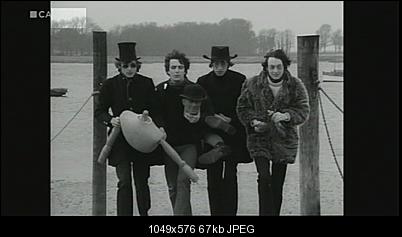

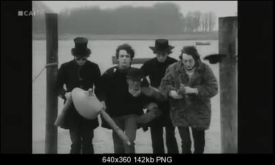

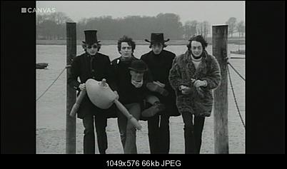

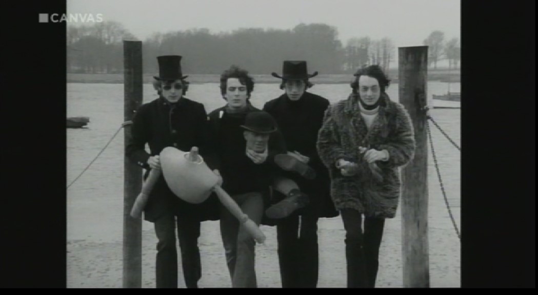

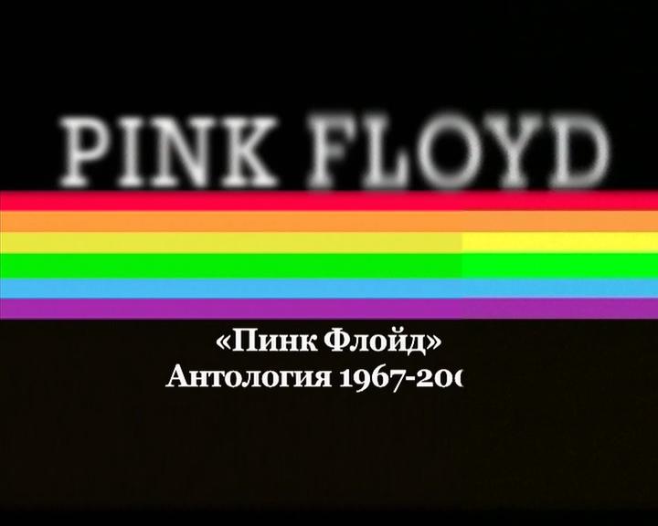

    I want to remove a watermark from a video. I have two sources. The first one has the watermark on the right, the second one has the watermark on the left, as shown below:

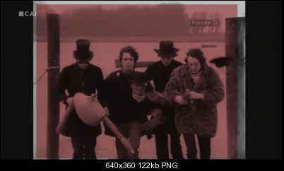

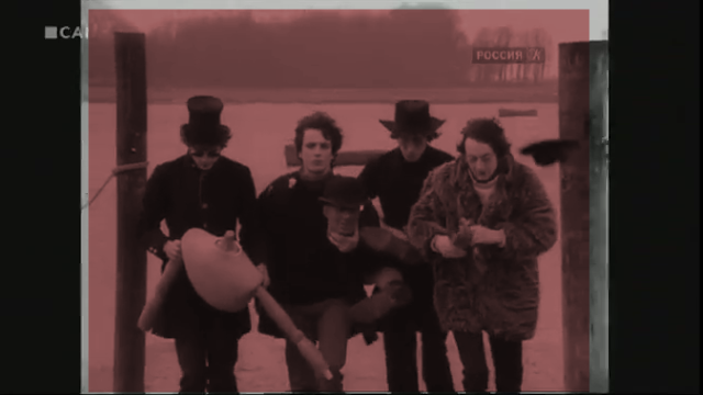

    In Sony Vegas, I have merged the two videos, using the second one as the main source, trying to remove the watermark using the first one. That's what I get:
    Nothing complex here. Of course I have to correct brightness, color, etc, in order to have a better result. But even doing so, the result is not as smooth as I expect. Does anyone have any suggestion to balance the two sourcer in terms of brightness, contrast, color, etc? Thanks!

    Look for the "Bezier Masking" tool. It's inside the "Pan/Crop" tool. You simply draw a mask where you want it. You also have to color match the images.
    This example clearly illustrates the logo removed. But the images are not color matched so you can see the work area as a brighter rectangle.

  3. You have other problems than color and levels matching - the aspect ratio and field of view is different . So in some other frames the "patch" won't match even if you matched the color & levels, because the frames aren't aligned
    And are you sure you want to do it that way ?
    Source 1 looks better in terms of quality & detail, but Source 2 has a larger field of view. Source 2 looks like a bad upscale or poorly resized
    I would probably try to align them (it's going to be a non centered, non linear resize), and take Source 1 as the main source (since it looks better in terms of details), and fill in the periphery and cover the right logo with Source 2

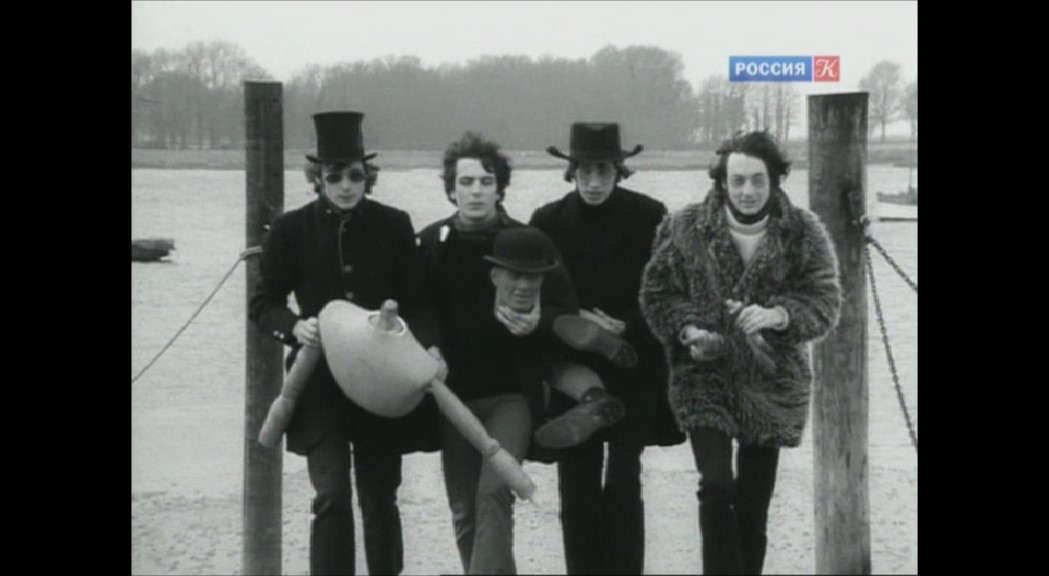

    You don't want to match 1 to 2 either, in terms of color or levels, because they are wrong (low contrast, wrong levels)
    But as mentioned above, you have more problems than just color and levels. They might be temporally aligned (same frames), but they are not spatially aligned
    Do you have a short sample video of both ?
  6. preferably a non re-encoded sample . Cut directly from source. Youtube will re-encode it. You can upload directly here (push the upload files button)

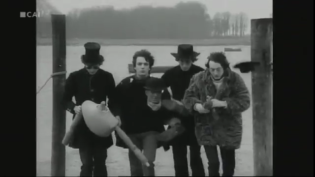

  7. Even if you line them up perfectly and match color, source 1 has a cropped image and won't cover. (As poisondeathray said.)
    And FWIW, I saw no color differences loading your YouTube samples into After Effects.

    Here are the samples, sources 1 and 2, without re-encoding.

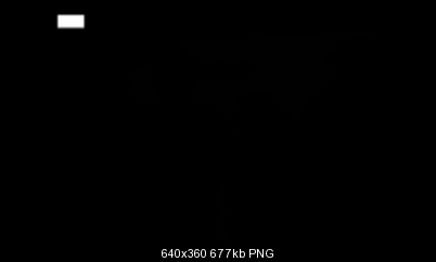

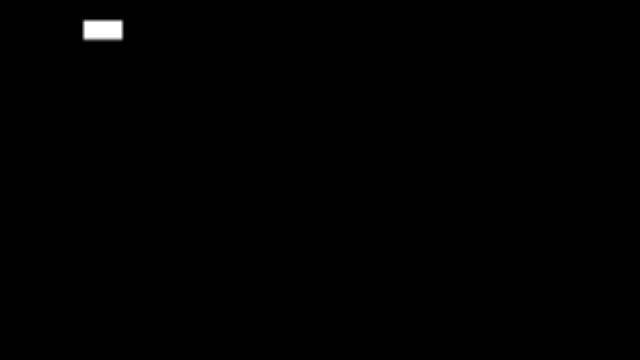

    Just feather the edges or the overlay mask. I didn't even bother to match levels and colors but you can barely see the overlay most of the time. Note that the clear image did not extend all the way to the edge of the frame so a little bit of the logo is still visible at the far left.
    v1 = ffVideoSource("source1.mp4").BilinearResize(456,342).ConvertToRGB().AddBorders(82,9,102,9).ConvertToYV12()
    v2 = ffVideoSource("source2.mp4")
    omask = ImageSource("mask.png").ConvertToYV12(matrix="pc.601")
    Overlay(v2,v1,mask=omask)
    Crop(74,0,-86,-0)
    mask.png:

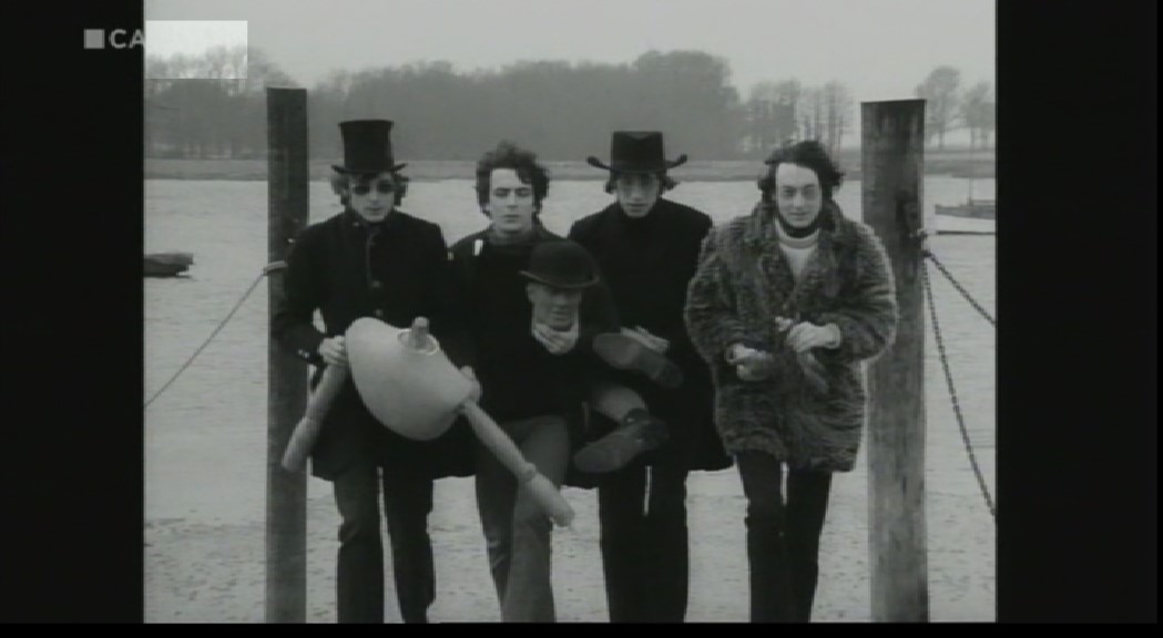

  14. I got the MPG 2 files and adjusted my script:
    v1 = Mpeg2Source("source1.d2v").Trim(7,0)
    v2 = Mpeg2Source("source2.d2v").BicubicResize(720,576, 0.33, 0.33, 95,15, 514, 546).ColorYUV(gain_y=67, off_y=-2, cont_u=-50, cont_v=20).ColorYUV(off_y=27).ColorYUV(off_y=-27)
    omask = ImageSource("omask.png").ConvertToYV12(matrix="pc.601").Blur(1.0).Blur(1.0).Blur(1.0)
    omask.png:
    The patch is nearly invisible now.

  16. Originally Posted by budwzr View Post
    I was unable to get a clean box using Vegas.
    One problem is that sourc1.mpg has crushed brights. After otherwise matching the levels I used ColorYUV(off_y=27).ColorYUV(off_y=-27) to crush the brights of source2.mpg to match.
