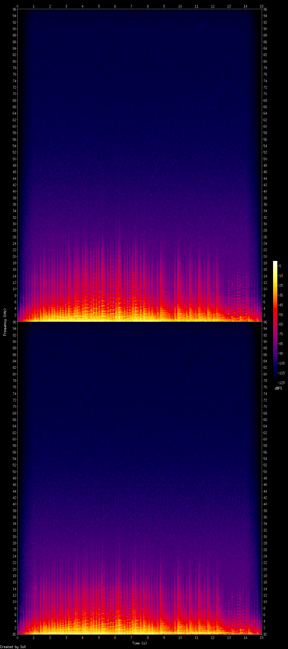

  6. Lossy conversion (requantization with noisehaped dither) to lossless flac.
    @ffmpeg -threads %NUMBER_OF_PROCESSORS%*1.5 -i %1 -vn -c:a flac -compression_level 12 -af "aresample=resampler=soxr:dither_method=shibata,aformat=sample_fmts=s16" %1_16.flac
    It should reduce size (not always) - extreme cases (192ksps 24 bit naim-test-2) by almost 3x times.
    Noise shaping is available for limited set of sampling frequencies (for anything higher than 48ksps - in example case noiseshaping "Shibata" was replaced by regular High Pass TPDF - for "normal" sampling frequencies noisehaping will made virtually lossy free requantization). In most of cases lossy transformation is transparent (from human auditory perspective).
    Original
    [Attachment 30469 - Click to enlarge]
    16 bit
    [Attachment 30470 - Click to enlarge]
