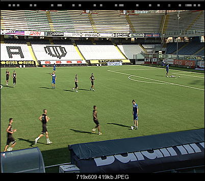

    please consider this IMX .mxf file (SD)
    https://www.dropbox.com/s/5jd9run51moczxh/imx.mxf?dl=0
    it's 608x576 with 32 lines upper
    I need to pass the video pack, without the 32 upper lines, so that I have a pure 720x576, to put in a mkv container
    I wonder: can I cut 32 lines from top using the -vcodec copy option of ffmpeg? ... maybe not
    so is there a way to pass in mkv the cropped video without transcoding all the file, or however is there a way to have exactly the same quality in the outputted mkv file?
    thanks
