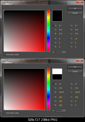

  15. I think I am slowly figuring this out. Using color picker in PP I see the following. Never understood before but I think I do now. PP rescales RGB 0,0,0 and 255,255,255 to luma values of 16 and 235.

  16. YUV 16-235 => RGB 0-255 is basically what a REC or "TV" or "limited range" conversion is in terms of 8bit values. There are slight differences between 709 and 601 in terms of color
    In contrast, YUV 0-255 => RGB 0-255 is a "PC" or "Full range" conversion. This is essentially what Sony Vegas uses in 8bit mode with Studio RGB. (that's Studio RGB, not sRGB)
    RGB and YUV are non overlapping color models. 8bit YUV can contain more information than 8bit RGB. What you see in the preview is RGB (ie. it's converted to RGB for display, even if the timeline is working in YUV), so you are only seeing part of the picture in the preview
    The thing to be careful about with DV (or any camera footage) is usable "superbrights" . Almost all DV camers record usable data in the range Y=236-255 , or the "illegal" range. So when working in after effects, that data is clipped, unless you work at 32bit bpc. Adobe products in 32bpc allow you to access YUV data before the RGB conversion so nothing is clipped
