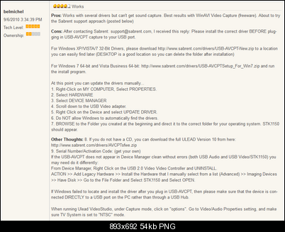

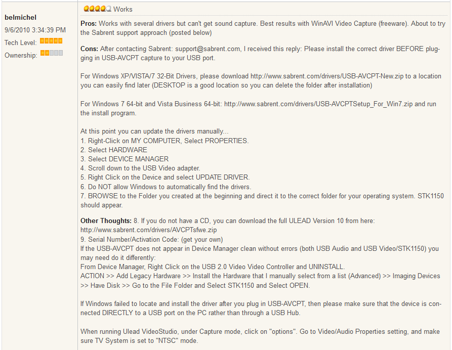

  8. You definitely have a driver problem and installing every drivers in the book for the same device is never a good answer. Doesn't help you're running Win 8, there is no mention of that capture device being compatible with it. Worse, the word is that the drivers on the CD are wrong. Though it's possible to install Win 7 drivers in Win 8, there may be issues to workaround. Anyway, if you wish to give it a try this is from a Newegg reviewer of the same device. He gives a good description on how to install the driver and how to get the software to work.

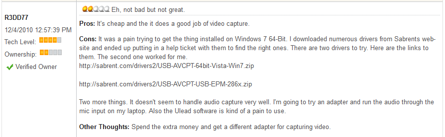

    This other review is not as detailed, but provides links to more drivers.
    Here's the actual links:
    32bit
    http://www.sabrent.com/drivers/USB-AVCPT-New.zip
    64bit
    http://www.sabrent.com/drivers/USB-AVCPTSetup_For_Win7.zip
    http://sabrent.com/drivers2/USB-AVCPT-64bit-Vista-Win7.zip
    Don't know about this one
    http://sabrent.com/drivers2/USB-AVCPT-USB-EPM-286x.zip
    Unzip all the drivers into separate folders, then create a new empty folder and move all four folders to it and point Windows to that folder to update the driver.
