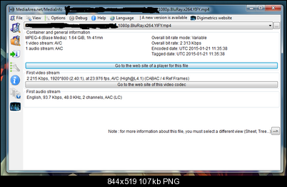

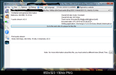

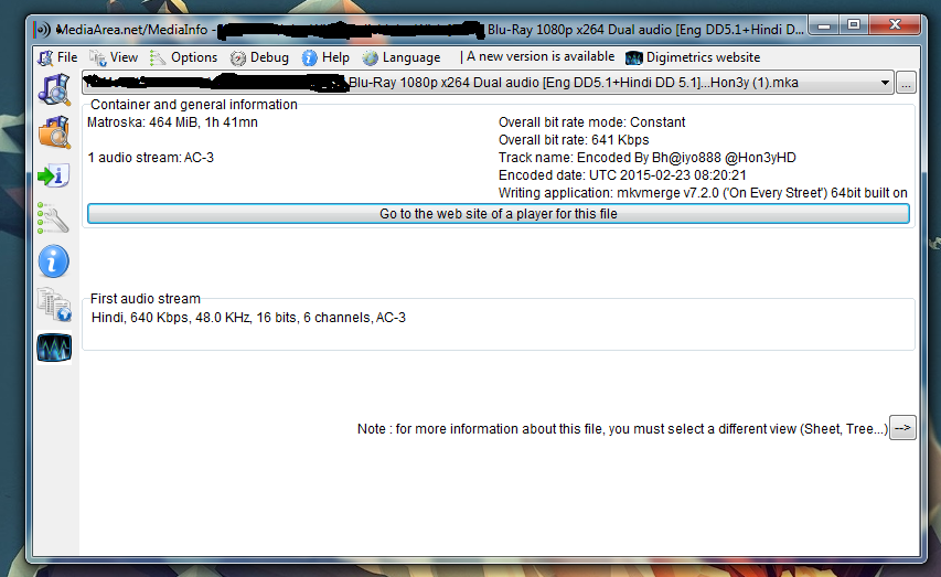

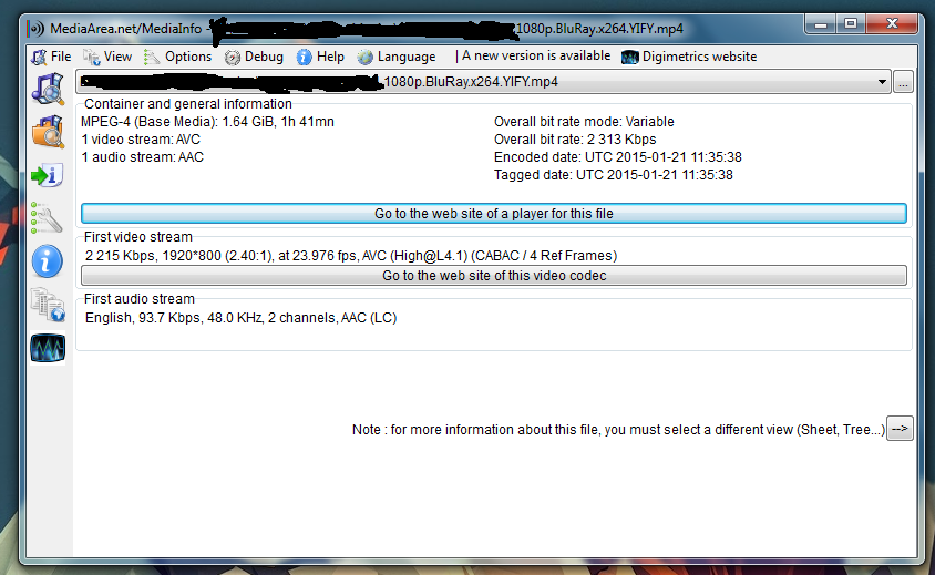

  6. here is some info
    you can see audio in the movie is too bad (as always from yify) so I want to better quality audio into it, so what should I do?
