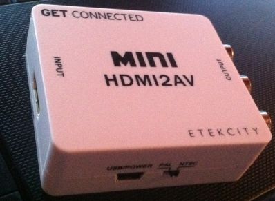

  3. How would I ascertain that? Pardon my ignorance.
    This is the converter attached in the photo.

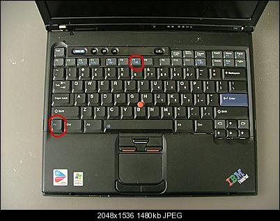

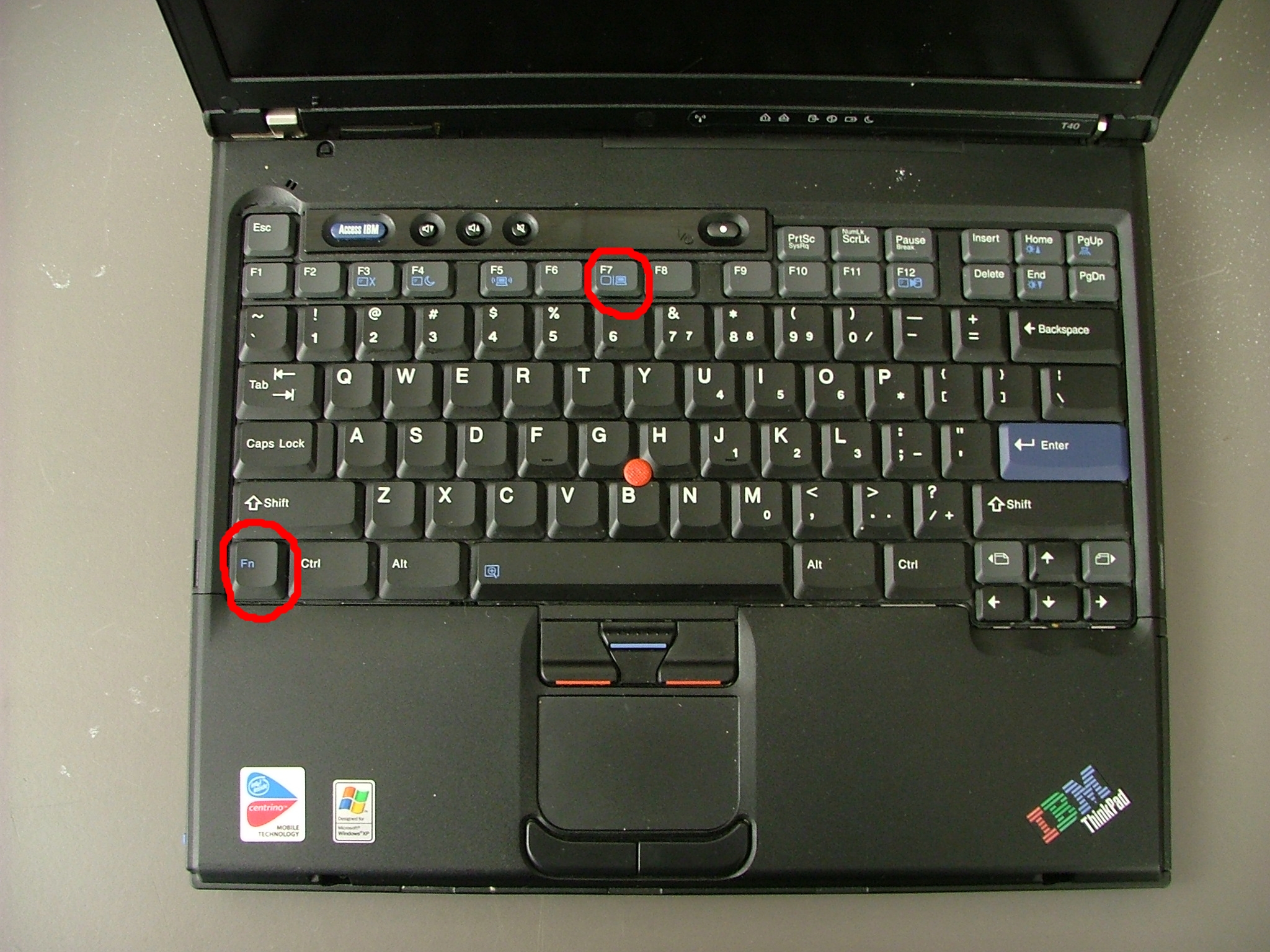

  8. As a rule there's a function key, probably labelled Fn and possibly with blue writing on the key. If you hold it down while tapping the display key, the laptop should cycle through the different display modes (single, mirrored, dual etc). The display key's probably the one with a "symbol" on it that might look something vaguely like a monitor screen if you use your imagination, and it might also be blue, but it'll be one of the F keys.

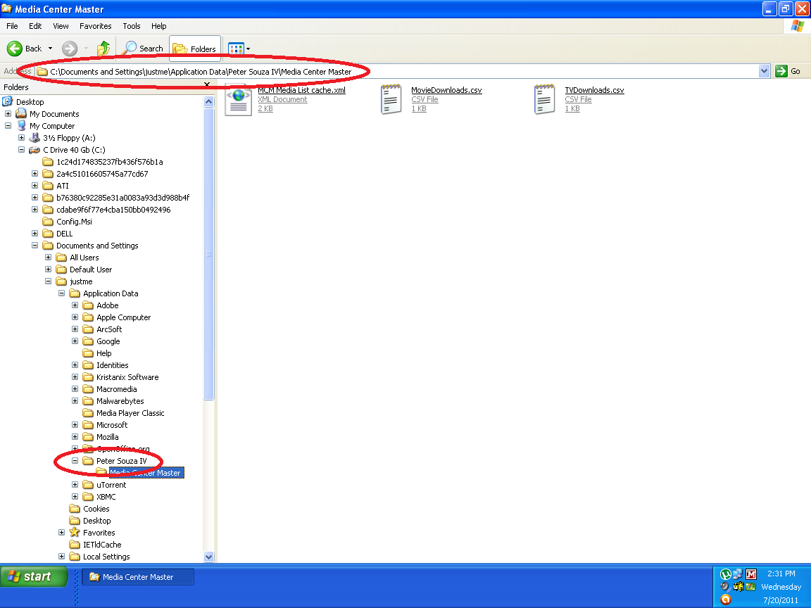

  10. You have another computer, the easiest solution is to get a 2.5" HDD enclosure, remove the drive from the dead screen laptop, put it in the enclosure and download your files directly to the other laptop. On Vista and above, you will find your files in the Users folder under your username. With XP look under Documents and Settings (this example is not my screen cap, ignore the red circles and the username is justme).
