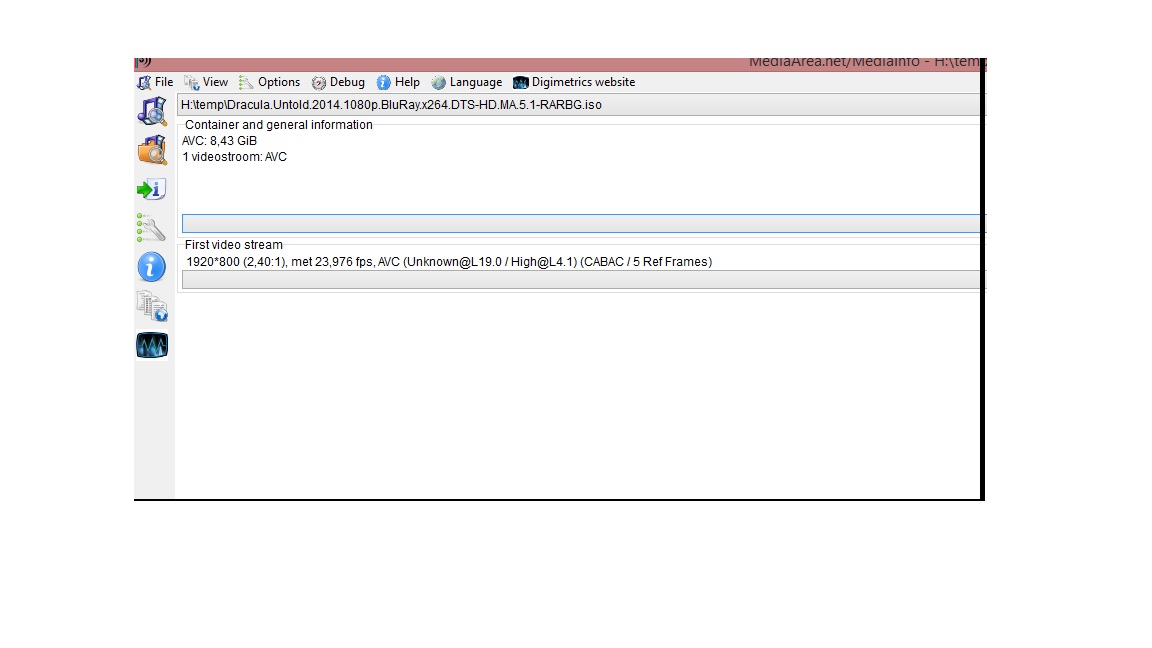

    yep it says 2.40:1 , i have no idea how to change it

    You re-encode it, adding 140 pixels worth of black bars each on the top and bottom to get it back up to 1920*1080.
    Or put it in an MKV and play it via USB.
    That's about all you can do.

    To be honest, I'm surprised it didn't just reject the video outright. 1920x800 isn't even a Blu Ray compliant resolution.
    Have you ever had a dvd where the aspect ratio in the ifo didn't match the aspect ratio in the stream? Or an MKV with the same problem? Really, Blu Ray HD is 16:9, it either obeys the specs and is predictable or it doesn't and then what?
