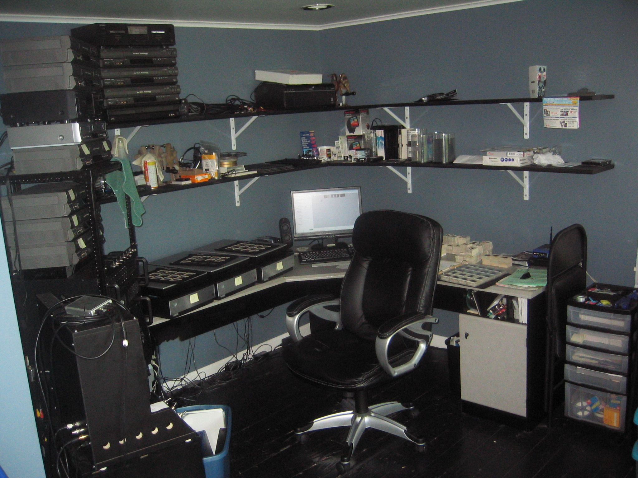

  28. This was 5 years ago in the early days when it was just me and my office, before I bought the TBCs.
    You'll see nine JVC SR-V101US VCRs, 2 cassette decks, 3 scanners, camcorders, a PC tower...
    [Attachment 30698 - Click to enlarge]

    something like one of these perhaps:
    http://mcetech.com/quickstreamdv/index.html
    http://www.datavideo.us/datavideo-product-families/datavideo-video-recorders/datavideo...rive-recorder/
    If you use an SSD in the recorder, then that removes all the moving parts from the DV capture. And no computer...
  30. Originally Posted by pippas View Post
    So why not just store the DV output from the Canopus card directly onto a solid state DV recorder?.
    Yes, sorry I did mean firewire from the canopus.
    Well now we're talkin! This is exactly what I need, and I found this, which is less cost than a computer... DV to 32gb flash drive, AVI.
    http://www.bhphotovideo.com/c/product/684200-REG/Canon_1751V350_FS_CF_Pro_Portable_Compact.html
    Oh my... change is gonna come wooo! It took awhile but we got there TYTYTY!!!
    This is my FINAL workflow...
    JVC SR-V101US --> S-video --> TBC-1000 --> S-video --> ADVC-55 --> Firewire --> Canon FS-CF, AVI, Flash Card
    No more computers for capture! HAPPY DANCE lol
