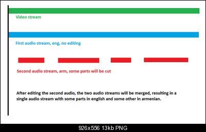

    The problem is, I cannot edit the audio independently. Let's see if I can explain what I'm trying to do.
    Source/input streams: a video stream (.h264), first audio stream (english, will NOT be edited), second audio stream (armenian, will be edited, some parts will be cut).
    The video and first audio stream come from an MKV file. The second audio is an MP3 file.
    Desired output: MKV
    I have to edit the second audio stream within a non-linear editor, so that I can match the parts that I want to keep with the correct scenes in the video.
    This image might help explaining it:Click image for larger version
  4. Originally Posted by eddman View Post
    Desired output: MKV
    It's not a problem. This is what video editors like NLE's do You are only using the video as a visual "guide"
    Most NLE's won't accept MKV as a container, and many have problems with a raw AVC stream, so you would need to remux to MP4 container or other suitable container, if the video is compatible (not all AVC streams are compatible with all NLE's)
    Or if it's just simple cuts, simple audio edits such as in your diagram, you can use the freeware aviutl, which does support MKV and many different types of AVC natively
