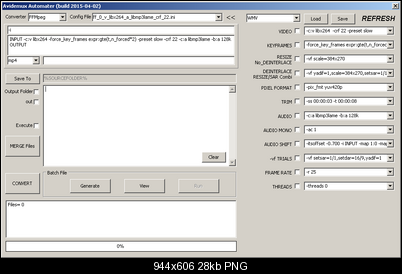

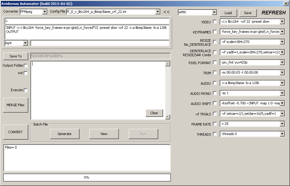

    You made me a ffmpeg freak. Once I realised that ffmpeg is a very powerful tool but needs to be used from command line, I made a front-end for it. Now I use my program for all of my conversion needs. I gave a name Avidemux Automater since I started with Avidemux controlling aim. Then I converted it to ffmpeg front-end and I implemented all the parameters that I need for my conversion purposes. Now I'm happy with it. Thanks for your guidance.
    Here is a screenshot:
