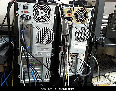

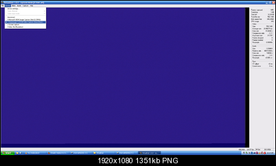

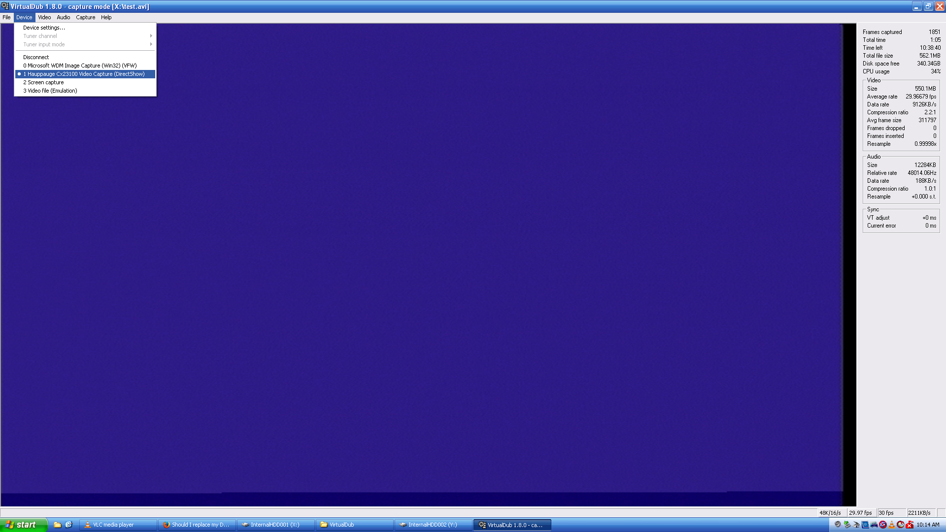

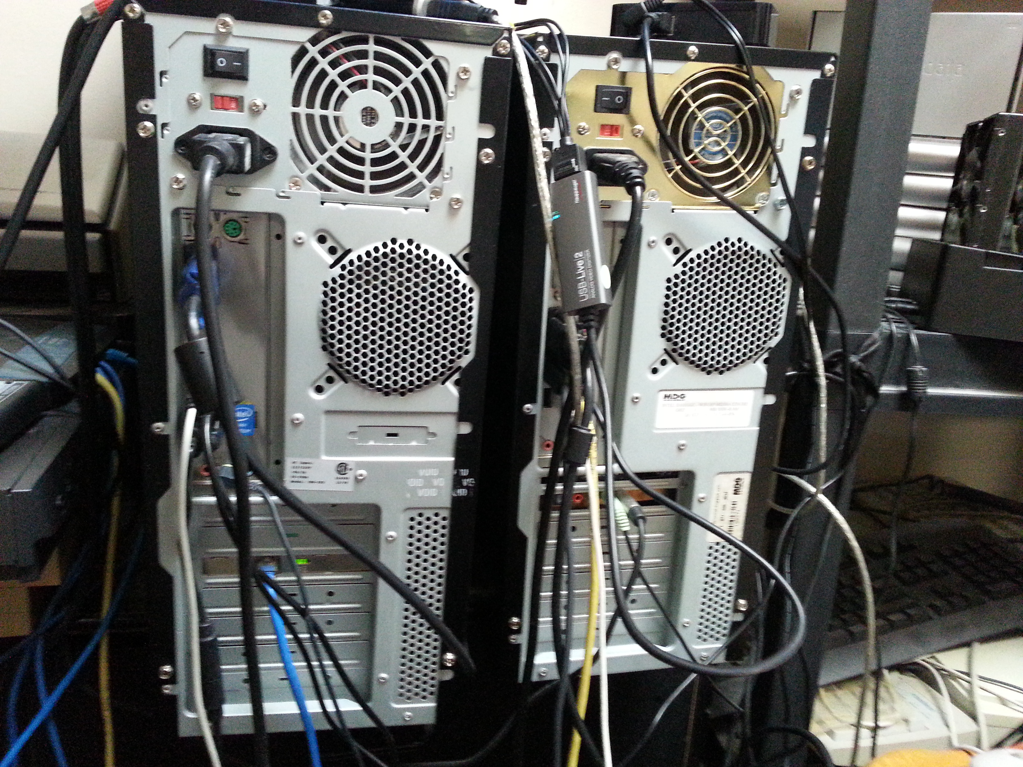

  10. Member PuzZLeR's Avatar
    Oct 2006
    Toronto Canada
    I have done some tests of my own the last few days and I have yet to see any overscan with the Hauppauge USB-Live2. I've done tests with VirtualDub, and even SageTV. Nothing.
    Honestly, I do have it!
    I can show many captures, but honestly, I have no overscan in any of them. Any specific test you'd like me to do?
