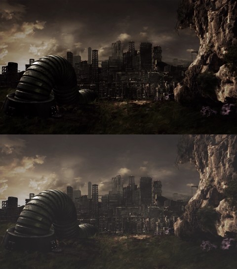

    For instance, here: http://www.thetvaddict.com/wp-content/uploads/2011/02/24-top-bottom.jpg
    While the bottom example looks washed out, it does display the detail in the guy's hair, for example...whereas the top example you see practically no detail in his hair.
    Then in this picture: https://forum.videohelp.com/images/guides/p2006437/levels.jpg
    You see much more shadow detail separated in the bottom image, at least on my screen, including making out the green grass.

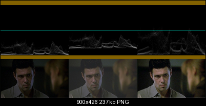

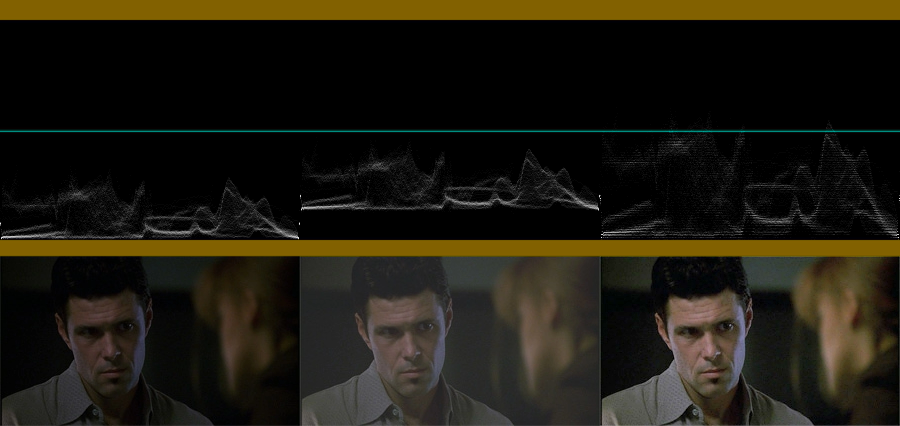

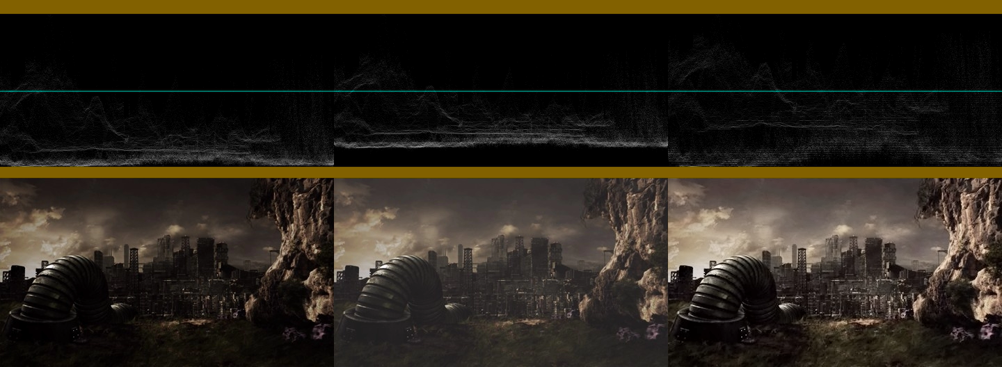

    I lifted the shadows here, and sure you can see more shadow details, but it's probably "too contrasty" for the "look" of the content
