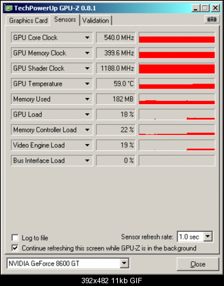

  3. How are you measuring GPU usage? Hardware decoding is a separate part of the GPU as far as I know.
    I've tried various combinations of MPC-HC, MPC-BE, Potplayer, DXVA and CUVID and so far none of it's made much difference. GPU-Z usually reports the same thing for the same video, although for some reason MPC-HC with it's internal CUVID decoder shows about 5% more GPU load than MPC-HC with ffdshow's DXVA decoding (for the 720p video I was playing with) but the "video engine load" and temperature stay about the same. I don't really know why the increase in "GPU load" but for me that happened with MPC-HC but not for Potplayer when comparing DXVA and Cuvid.
    If the video is running at a lower resolution the GPU load will drop compared to running fullscreen, but other than that I can't really explain your result. My old GPU seems to sit between 55 degrees and 60 degrees regardless of what it's doing.
    Give GPU-Z a spin to see if it reveals anything new.

  4. Originally Posted by hello_hello View Post
    It does. Although the Potplayer GPU usage and Speedfan GPU temp readings match with GPU-Z, the latter shows three other attributes which, I believe, explain the behaviour here. During CPU decoding, the GPU Core, Memory and Shader clocks are 405, 324 and 810 Mhz respectively, whereas during CUDA decoding, they are 549, 789 and 1339 Mhz. I think that about covers it.
    Thanks.
