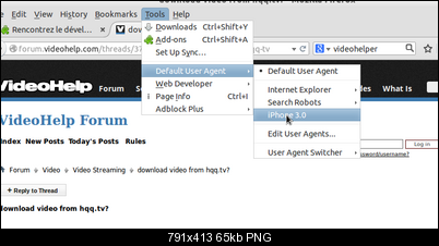

    i use firefox adblockplus addon and User Agent Switcher addon
    first i Switch to iphone 3.0 for the user agent

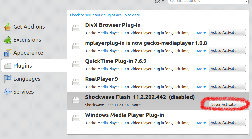

    then i desactivate flash player

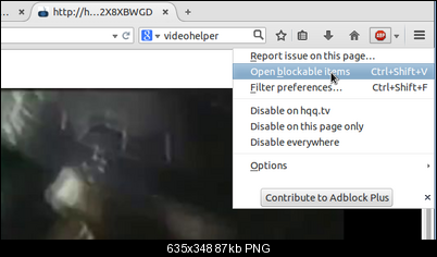

    i open the link http://hqq.tv/watch_video.php?v=874U2X8XBWGD
    i play the video (it doesn't start)
    and i use adblockplus

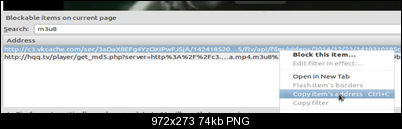

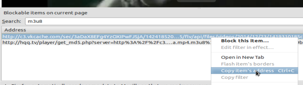

    i search for m3u8 and copy item's adress

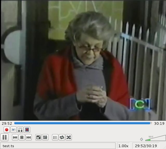

    after i use this adress with ffmpeg with the user agent's option
    i use ihone 3.0 user agent in firefox so we think that it could be used
    -user-agent "Mozilla/5.0 (iPhone; U; CPU iPhone OS 3_0 like Mac OS X; en-us)"
    but
    -user-agent ""Mozilla/5.0 (Windows NT 6.3; rv:36.0) Gecko/20100101 Firefox/36.0""
    works for me too
    hoping that it might help
