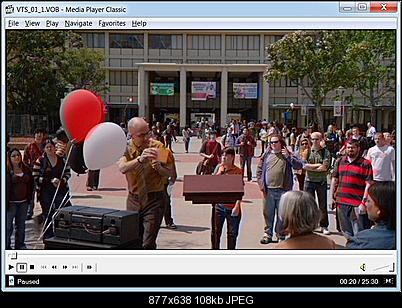

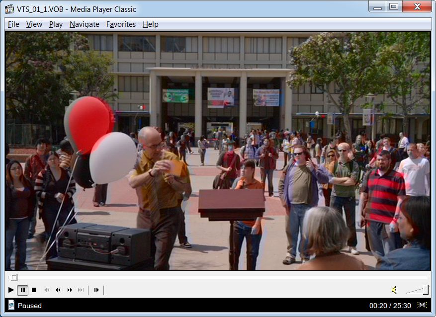

  4. You can also do this in software during playback. For example, you could use ffdshow as your coded and add AviSynth's ChromaShift() function to shift the chroma channels. Here's MPCHC playing a video with ffdshow shifting the chroma 8 pixels to the right:

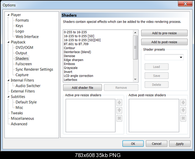

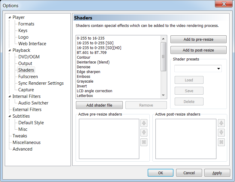

    Or you can write your own shader that works with MPCHC:
    [Attachment 30322 - Click to enlarge]
    [Attachment 30323 - Click to enlarge]
