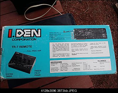

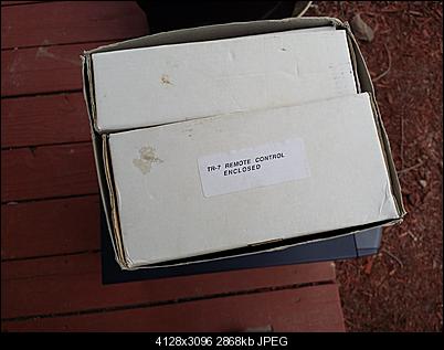

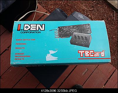

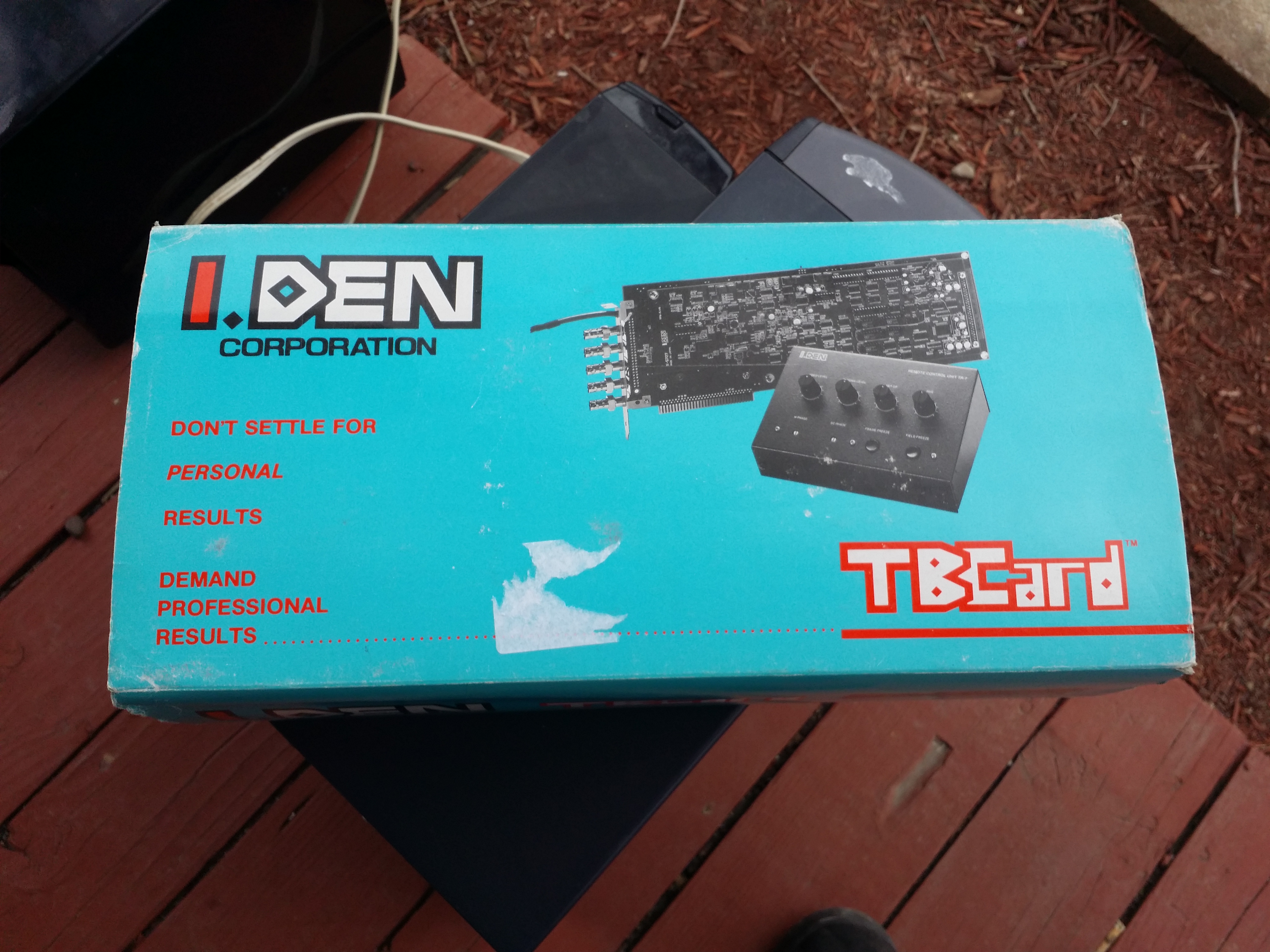

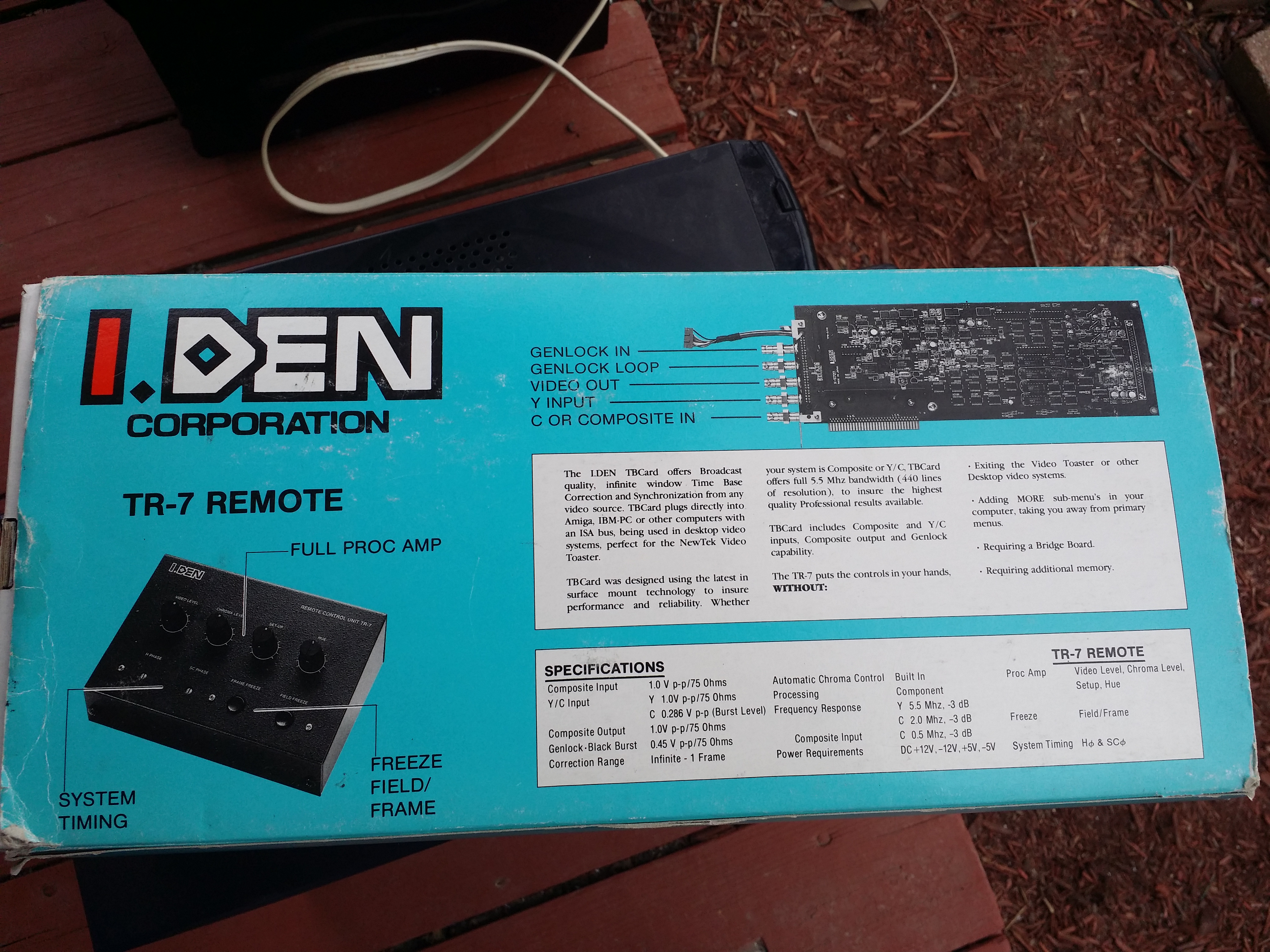

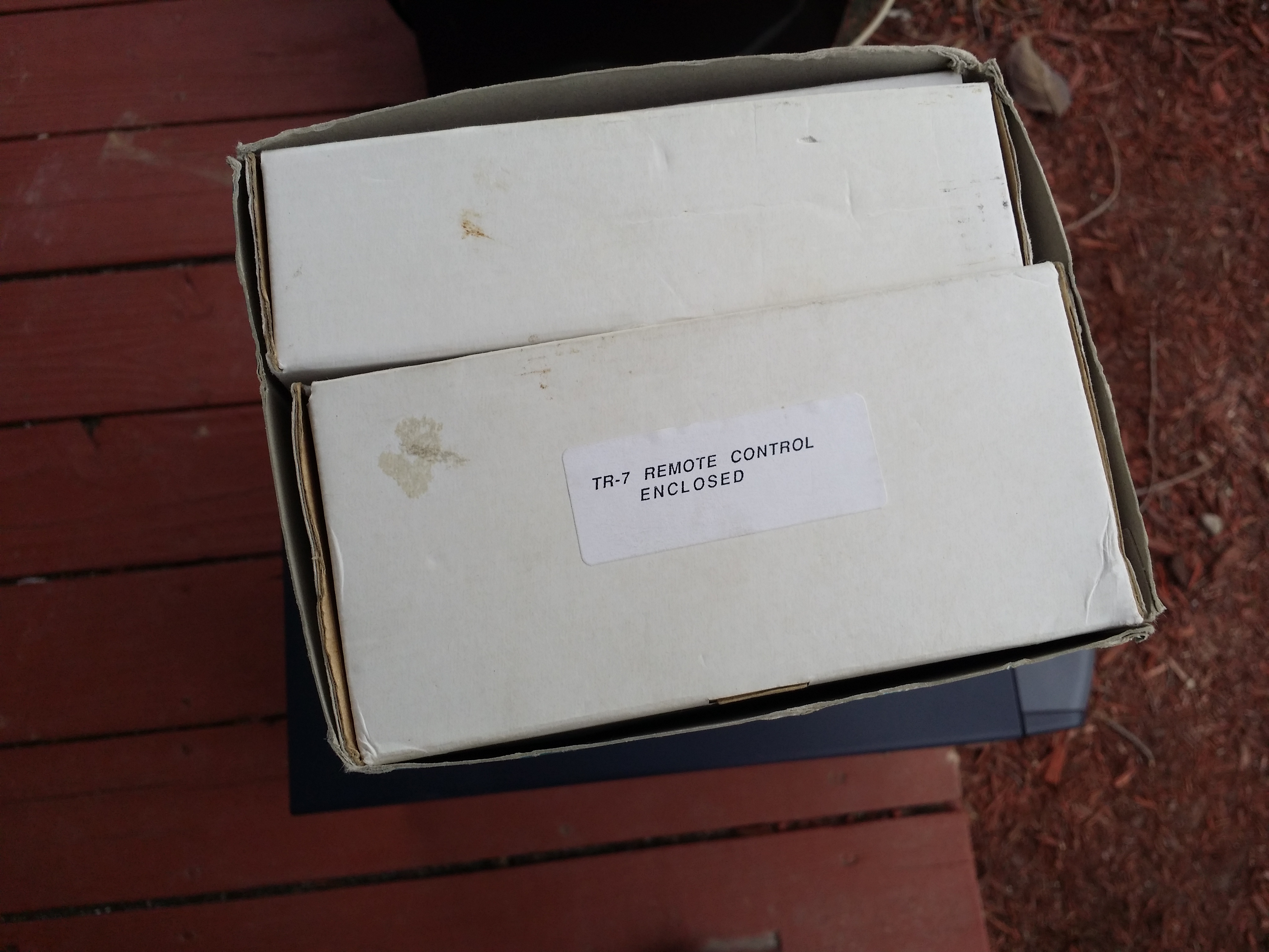

  1. Looks brand new never used. I know it's a time based correction card but what exactly does that entail and is this thing worth anything in todays market?

  2. Member Cornucopia's Avatar
    It's a Gen-locked TBC, which can be quite helpful for image stabilization & synchronization.
    However, this unit uses an ISA card slot and those stopped being available in MOBOs years ago, so the only PC you'll find that you could use it in would be an ancient one.
    Plus, it only supports SD (probably only NTSC by the look of it), and only with Composite or Y/C input, and Composite output - severely limiting its current usefulness.
    Plus there is no mention of drivers, so unless it is mean to be INDEPENDENT of the OS (a possibility, given its era), you'd have to obtain drivers to get it to interact with the (supported) OS. And if that's the case, the choice of OS is probably a sticking point also.
    So it's really only a retro, niche device, if still working(?).
  3. I had a feeling it would be a very niche thing if it's usable at all to someone. It all looks brand new though, with the original bubble wrapped around the cards and tapped. I may just throw it up and see what happens, nothing ventured nothing gained lol.

    '440 lines of resolution' ?
  5. Originally Posted by DB83 View Post
    5.5MHz bandwidth

    I agree that the device is not going to be useful to most people looking for a TBC.
    It is possible to buy a system or a motherboard that has ISA slots if someone really needs one. They are still produced, although they are not cheap. http://www.amazon.com/dp/B004HLOQH6/?tag=stackoverfl08-20 However the OS and drivers could still be a problem.
  7. If it only needs power from the ISA slot you can probably just solder some wires to it. Or to an ISA connector and plug the card into it. What does the remote control plug into? The computer or the board?

    Commodore Amiga collectors are the most likely group to be interested in the device. The package mentioned "Video Toaster", which was originally used with an Amiga.
