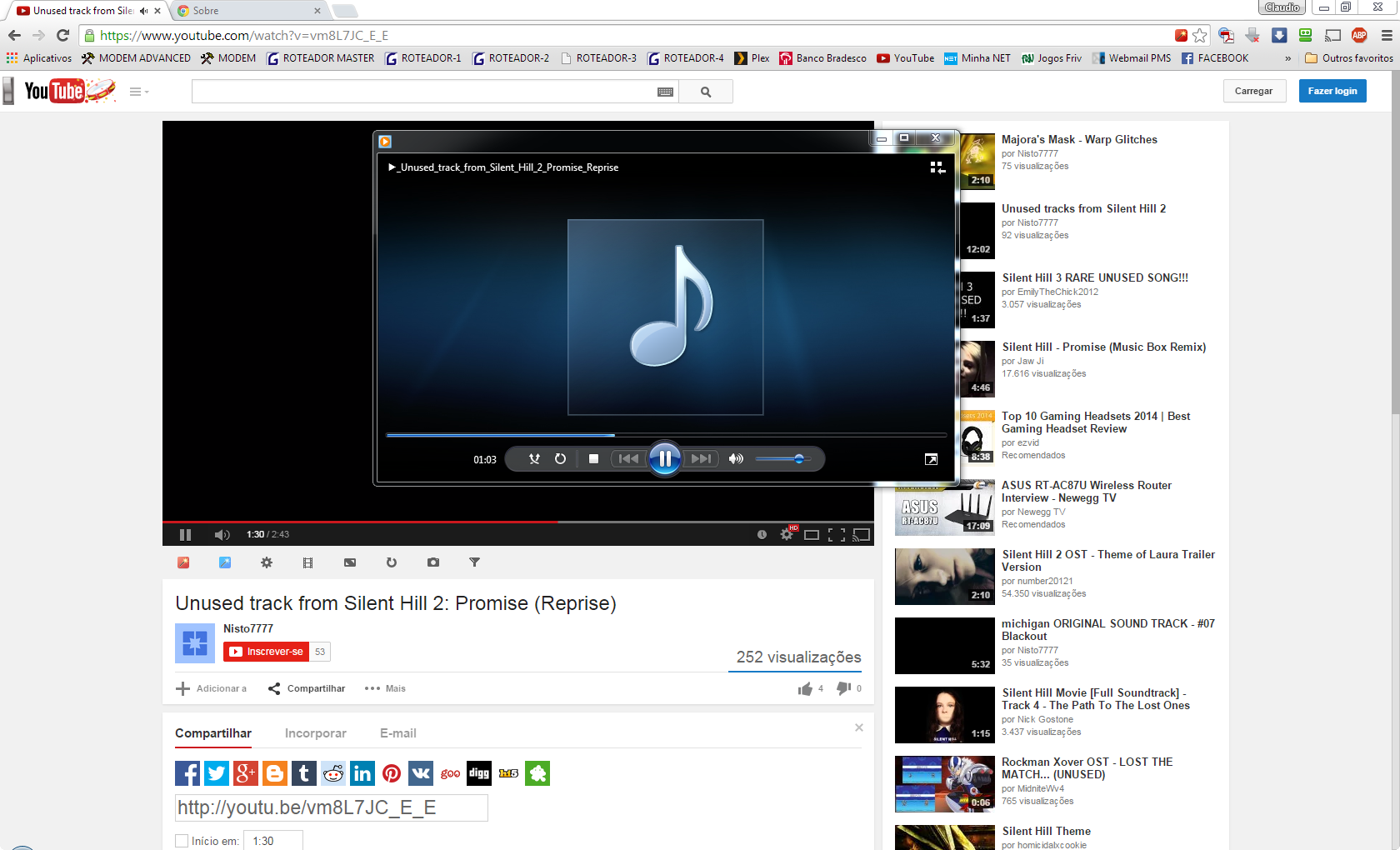

Only recently have I discovered that in some cases users will have problems with playing videos that I've encoded using this method. They play fine in Firefox (35) and Chromium (40), but several people report that Chrome (which isn't quite the same as Chromium) gets stuck at some point. For example, several people have reported that Chrome gets "stuck" at 0:19 in this video. I haven't tested it on Chrome myself as I only have Chromium here. But someone told me it's only on HD resolutions that they're having this issue.
So I'm wondering what the problem could be, and also, is there a way I can improve the compatibility with YouTube? Is there an overall better (and faster maybe?) way to do blank videos with audio? All video players I have available on my computer (which supports x264 anyway) can play the original video encode just fine, so I don't know why some browsers are struggling to play back the YouTube encode...
