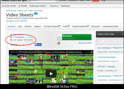

  1. Banned
    Oct 2014
    Northern California
    That project appears to be abandoned.
    A shame!
