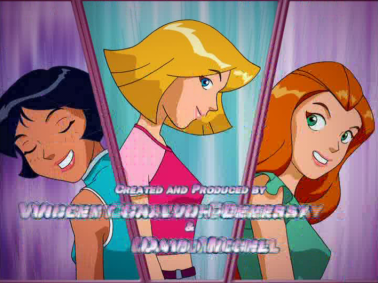

Results 31 to 43 of 43

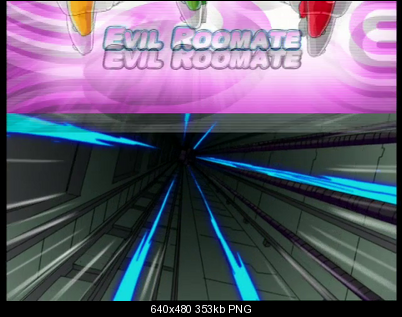

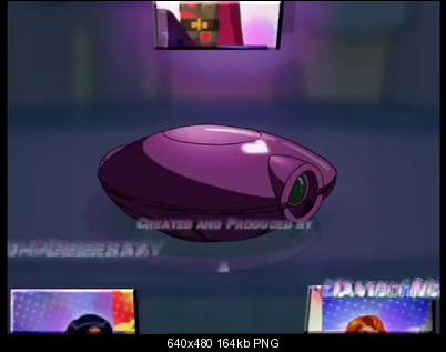

    Difference is, this video is progressive instead of interlaced (576i->480p) and not upscaled. The bitrate is also a bit horrible, causing artifacts.

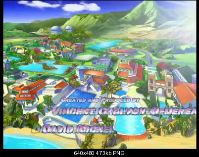

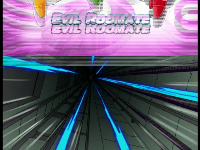

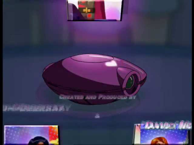

    1. Is there a way to get rid of this:
ID:	32672Click image for larger version
ID:	32673Click image for larger version
ID:	32674Click image for larger version
    Script doesn't, with or without SelectEven()
    2. Is it possible to reduce more of the compression artifacts? The script does something, but at certain points, it's too blocky (e.g. during fast motion)
    Script:

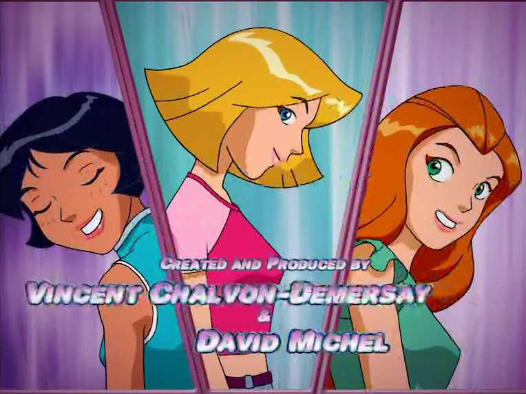

  4. In the original PAL video had interlaced titles overlaid onto the progressive frames. Whoever resized the video from 576 lines to 480 lines didn't account for that interlacing so the titles are now a partial blend of the two interlace fields. I don't see any good way of fixing this. You can try blurring combing away but the rest of the picture will get blurry and the combed areas will still look like double exposures. Something like this with sample2.mkv:
    ffVideoSource("sample2.mkv")
    src = last
    Spline36Resize(width,height/2)
    vInverse()
    Spline36Resize(width,height*2)
    Sharpen(0.0, 0.5)
    ReplaceFramesSimple(src, last, Mappings="[35 42] [80 96]")
    Another way you could approach the problem is to recreate the segments with the problem, using animated overlays.

  6. Originally Posted by jagabo View Post
    Heh, didn't know Avisynth could do that, thanks!

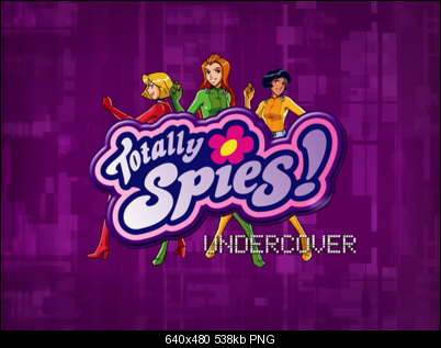

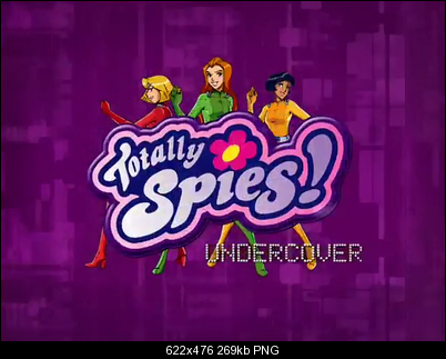

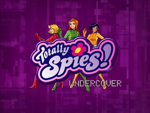

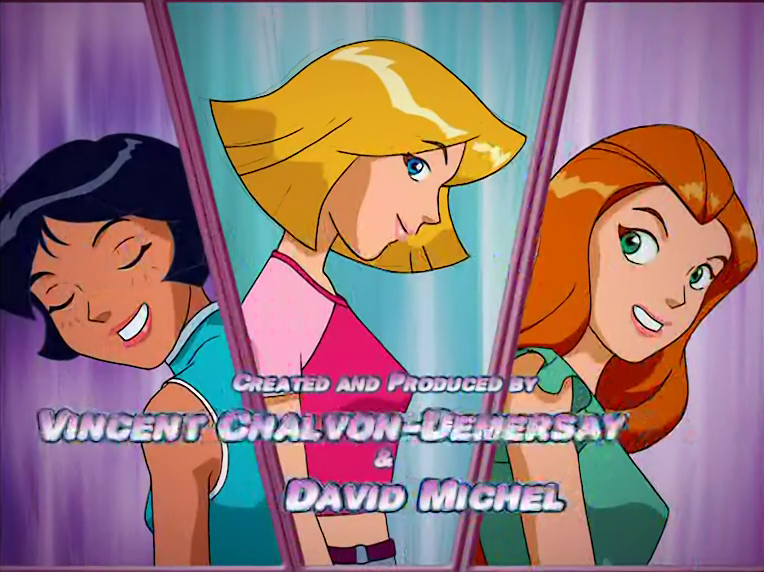

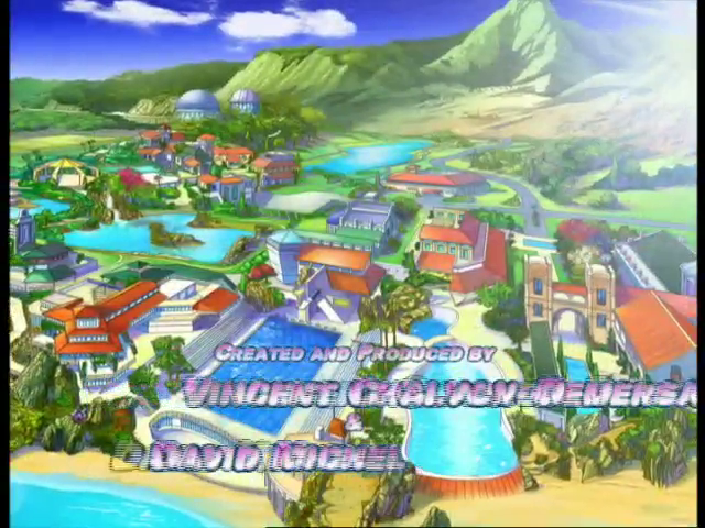

    I still have one problem though. With high motion, the image goes to hell due to the fixed bitrate on the source (it also seems that the titles from sample1.mkv are jiddering due to that):
    The other two that look right are from a PAL (1st) and NTSC (2nd) DVD. I've lowered the CRF and set qcomp at 0.9. AWarpSharp2 (+toon) makes the video a bit less blurry, but the non-black lines are still blurry or have disappeared completely. Also, when fading from black to color, the image also looks bad.

    Are the compression artifacts reversible or is it possible to tone them down a bit?
    ffVideoSource("input.mkv")
    LSFMod(defaults="slow")
    AWarpSharp2(depth=11, chroma=3)
    Toon()
    Crop(10,2,-8,-2)
    Dither_convert_8_to_16()
    gradfun3(lsb=true,lsb_in=true)
    Ditherpost()
  7. I don't think you can really fix the loss of detail from over compression. At least not easily. In some shots you could overlay a clean frame over non-moving parts of the frame. Or maybe you could use a very strong aWarpSharp to clean up some of the rough/blurry edges -- on only the worst frames so as not to mess up the rest of the video.

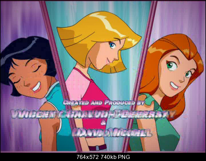

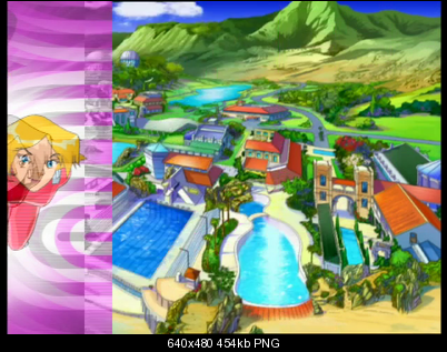

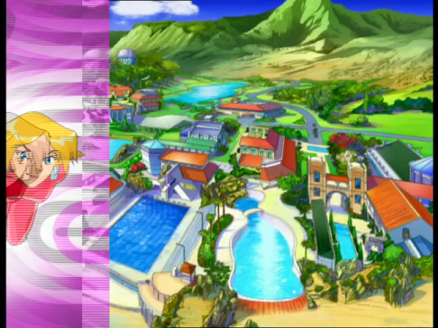

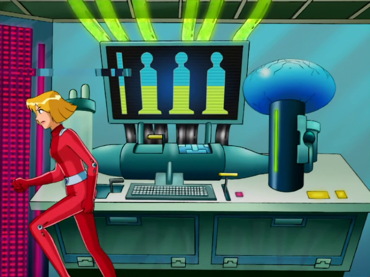

  9. Same show, different problem with deinterlacing. Something is causing (I think) ghosting, see the hair and credits
    Before (sample.mkv)
    After
    Replacing FPSDivisor=2 with SelectEven/Odd doesn't change anything, TFM reduces it a bit but causes aliasing everywhere, the QTMGC Preset Very Slow reduces it without aliasing but the lines are thinner.
    Is it QTGMC or is the source just too noisy?
    Script:
    MPEG2Source("sample.d2v", cpu=6)
    QTGMC(Preset="Slow", FPSDivisor=2, EZDenoise=3.0, NoisePreset="Slower")
    MosquitoNR(strength=15)
    Ditherpost()
    turnleft()
    nnedi3(dh=true)
    turnright()
    spline36resize(768,576)
    Crop(2,2,-2,-2)
    Toon()
  10. Yes, QTGMC sometimes leaves ghosts like that. You might be able to fix it by playing with the parameters. The ghost lines are from the prior or next frame so look into the temporal filtering options.
  11. Code:
    QTGMC(Preset="Very Slow", FPSDivisor=2, EZDenoise=4.0, NoisePreset="Slower", Sharpness=0.5, Lossless=2, TR0=1, TR1=1, TR2=0, sourcematch=14)
    removes it, thanks for the pointer.
    Is there a way to repair the lines?
  12. Which setting was responsible for fixing the ghosting? You can try an anti aliasing filter like Santiag() to fix the aliasing artifacts QTGMC introduced (if you can't find QTGMC settings that get rid of them).

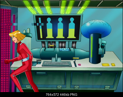

  13. Originally Posted by jagabo View Post
    The combination of Lossless=2, TR0=1, TR1=1, TR2=0, sourcematch=14. I'll try santiag. In the meantime, this happens later on in the video. Same script + the new QTGMC line. This happens randomly multiple times and doesn't appear in the source.
    I'm not sure what to call it.
