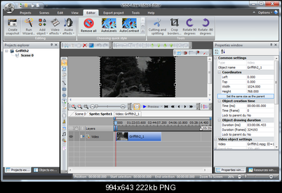

    I've completed the operations to remove a portion of a video. Now, when I open the project, I have a screen like this:
    Note that the project Griffith2 has a Scene0 which is 5.5 hours long. This is the length of the original MPG that I imported into the project. It is the only MPG I've imported into the project.

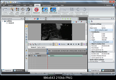

    Also, there is a "Sprite:Sprite1" tab in the editor -- lower pane, in the middle of the window. Here's what it looks like:
    I produced this by starting with the program in the state where it was in the last image, clicking on the "Sprite:Sprite1" tab, then clicking on the "Griffith2_1" video block -- the blue rectangle in the editor, middle lower pane. Note that it's duration (in the properties on the right) is 3 hours -- this is what was produced after I edited the original 5 hour vid to 3 hours and clicked "Apply Changes".
    But when I tell the project I want to convert it, it appears to convert the entire 5 hour one, not the 3 hour "scene". How do I tell the software that it is the scene I want converted? Or, how do I save this project so that the scene is all that is in it, so that converting the project only converts that 3 hours? Or is there some other combination of operations that will get me a 3 hour DVD out of this project?

    In the lower pic in your last post you will see a white vertical line at the original end point on the time line. Drag this line back to the end of the edited layer, then export.
    There is a way to get the software to automatically shorten the length of a cut portion - when you click on 'save changes' in the cutting screen a window appears saying "Duration of source file changed. Do you want to change duration of object?" Click yes.
    This is in version 2.3.1.339
