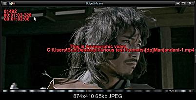

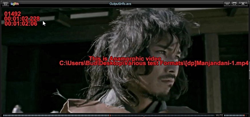

    You may have better cuts if you cut at frame boundary and I have had very good luck playing the video by loading an AVS file with the following lines:
    DirectShowSource(("C:\Users\Bud\Desktop\Various test Formats\[dp]Manjandani-1.mp4"), Pixel_Type="yuy2").Crop(0,0,-0,-0)
    ShowFrameNumber(scroll=true, x=10, y=27, font="Arial", size=24, text_color=$ff0000)
    ShowTime(x=72, y=44, font="Arial", size=24, text_color=$ff0000)
    ShowSMPTE(fps=23.976, x=68, y=61, font="Arial", size=24, text_color=$ff0000)
    If gives a video to select times such as:
Name:	ScreenHunter_136 Feb. 12 23.18.jpg
    Then use the batch enties Baldrick provided but with times in greater detail:
    ffmpeg -i video.mp4 -ss 00:00:00.000 -to 00:01:00.251 -c copy clip1.mp4
    ffmpeg -i video.mp4 -ss 00:01:01.251 -to 00:03:30.684 -c copy clip2.mp4
    ffmpeg -i video.mp4 -ss 00:05:00.112 -to 00:07:00.254 -c copy clip3.mp4
    pause
