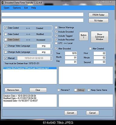

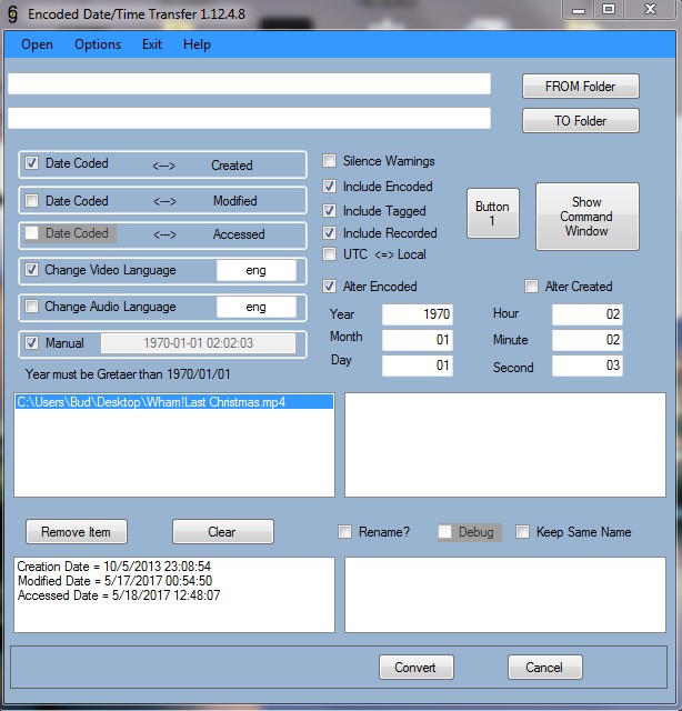

    @user1842 I know it should be apparent but having written a program and added this feature, there are many possibilities.
    My program is designed to take the Created OR Modified date and create the UTC Encoded/Tagged Date from it. It will also go the other way using the UTC Encoded/Tagged Date and change Created/Modified Date to match.
    I have recently added the language feature but have to finish the code to go with it. As it stands, If you wish to change the Language it will be Created ---> Encoded direction, changing the encoded date and will change the language as well. Would this be a problem? Or do you want just Language changed?
    It also does a folder at a time with alarm messages that can be turned off. It creates a new file with added text to the name in the same folder or the same named file in a DIFFERENT folder. I never alter Original files except to read the metadata with MediaInfo.
    I am assuming you want the same Encoded date and created date but just change to Language. Is this correct? If this is correct, I can change the code but it will take a day or 2.
    You can also use a batch file to call an FFMPEG script Such as:
    for %%a in ("*.mp4") do ffmpeg -i "%%a" -c:a copy -c:v copy -metadata language:s:v:0=eng -metadata language:s:a:0=eng" "newfiles\%%~na.mp4"
    pause
