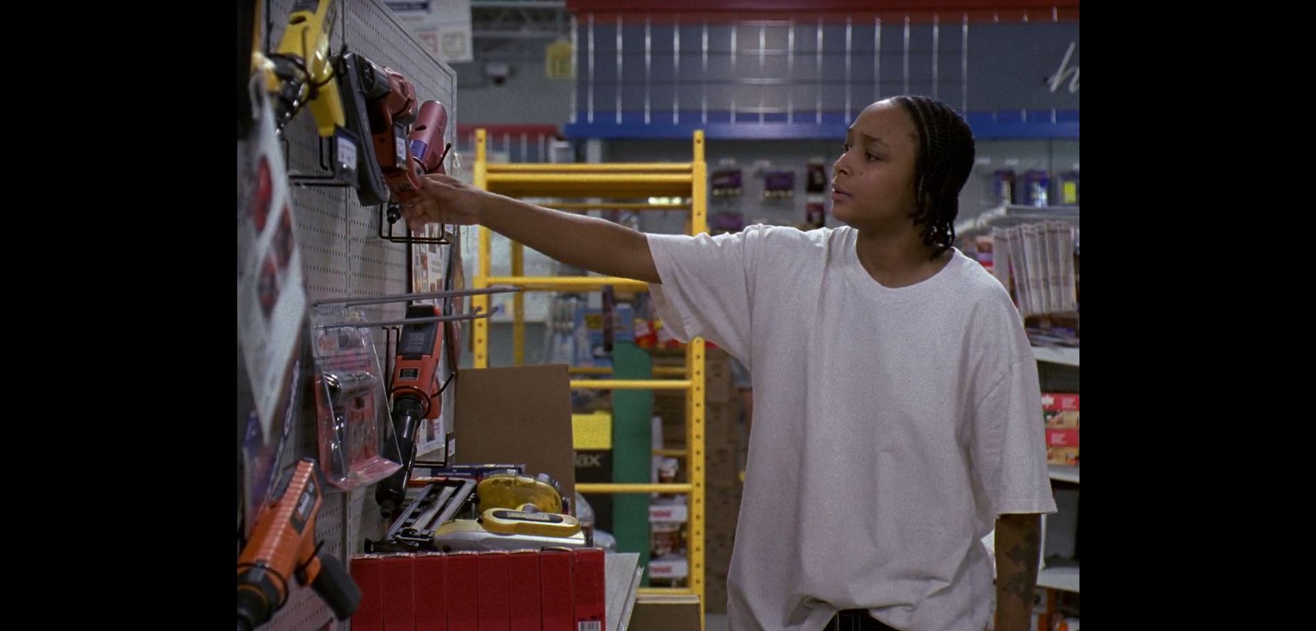

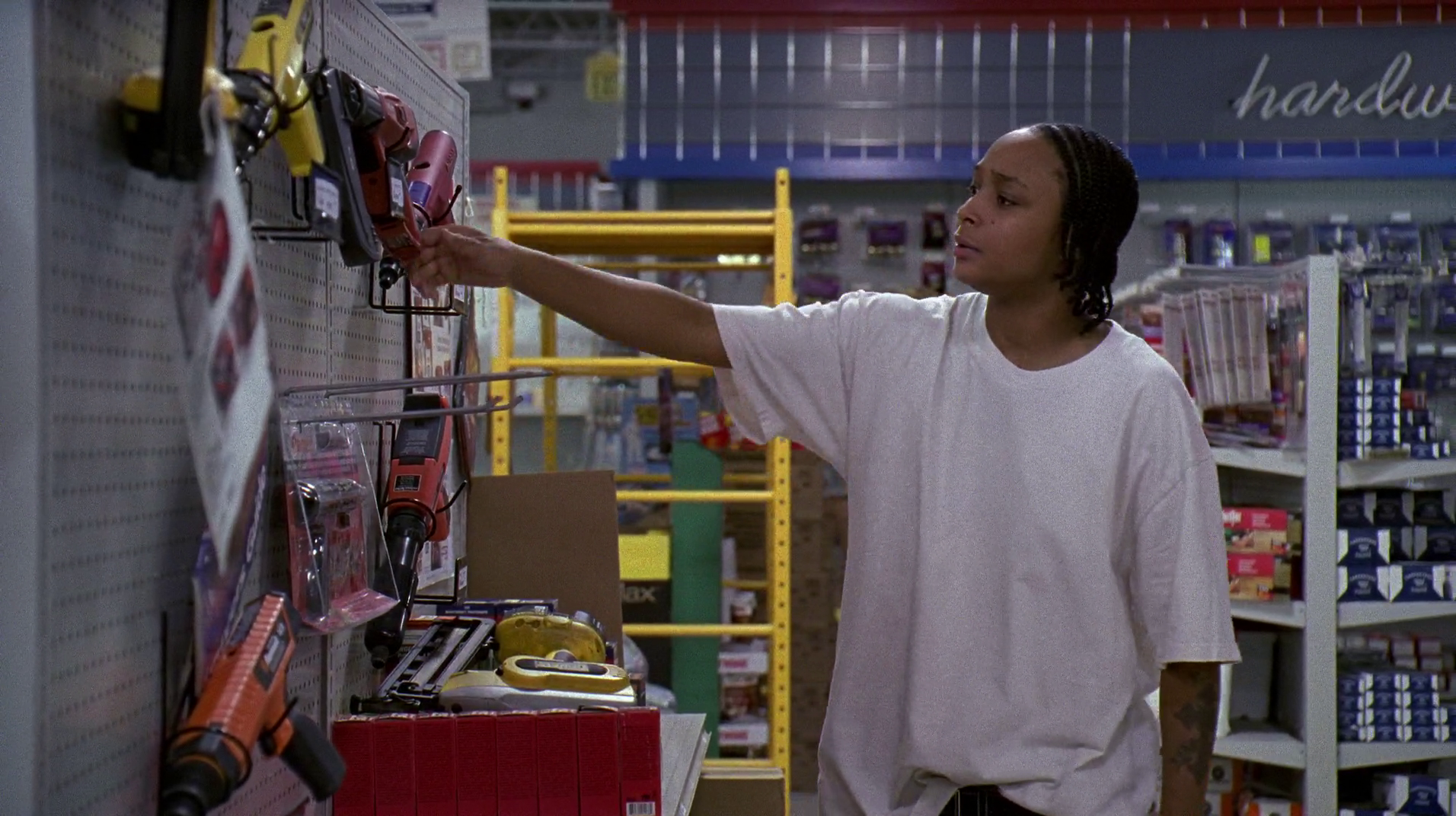

    I'm trying to take a bunch of 16/9 mkv files (1912x1072)
    and crop the sides in order to obtain a 4/3 file (1428x1072)

    I had no problem with the cropping, I opened mkvmerge gui, I used these settings

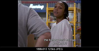

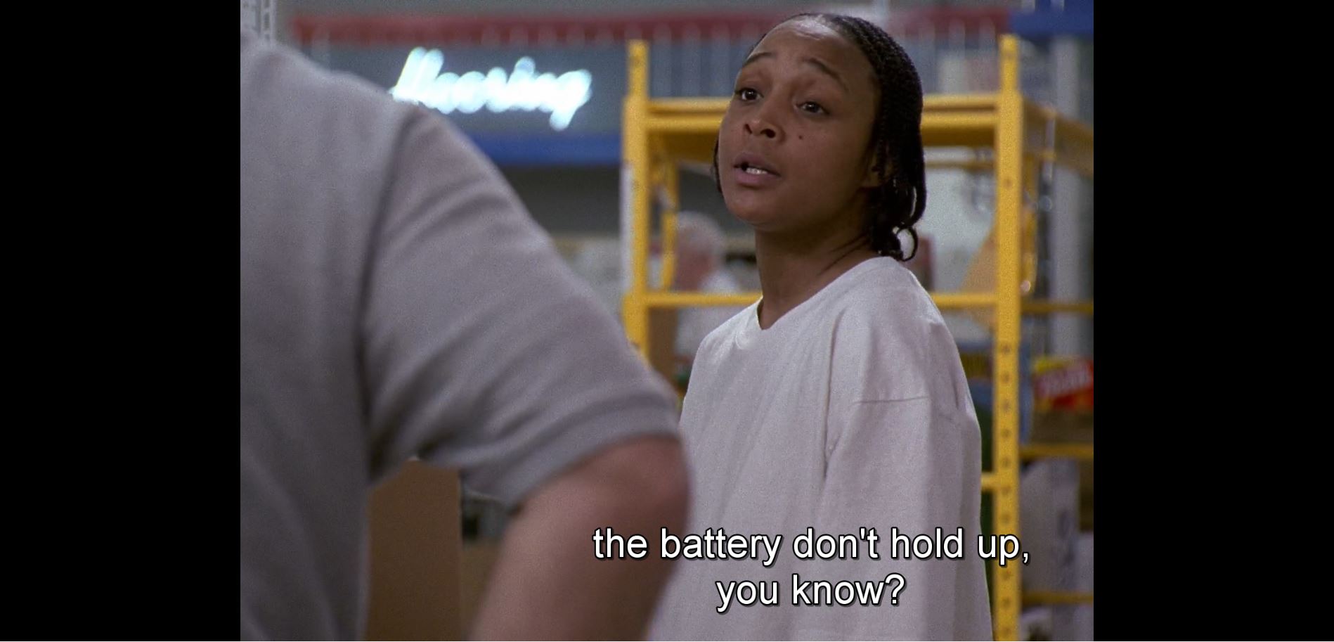

    Output file is ok, but the subtitles don't seem to care about the new aspect ratio
    They keep appearing at a 16/9 ratio, and when I stretch the pitcure to 16/9 in vlc, they are perfectly centered.
    I have to add that these are external subs, in a .srt format. The mkv has a built-in subtitle track, but it's also out of place on the screen.

  5. I'm up to date with vlc. I have to add that when I use vlc's built-in screencap fonction, the resulting picture isn't cropped, it's in its original 16/9 format. Maybe that's why the subtitles don't behave as they should? They think they're in a uncropped version of the file?
  6. VLC is probably calculating the subtitle position (center of the frame) based on the full frame size. Then placing the subs in the cropped frame based on that calculated position.
    I think that's exactly it... How can I make vlc "understand" that the full frame is the cropped verion? By changing the display aspect ratio?
