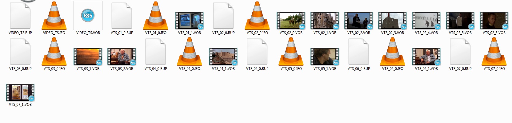

    What did you use (tool) to rip the DVD to the hard drive? Post a directory listing of VIDEO_TS folder.

  3. Thanks Keyser. I had to go out. Sorry for the delay.
Name:	Sin título.jpg

    Umm... The DVD structure seems to be OK. You didn't say which program you used to rip the DVD to the hard drive. I hope you're not trying to use DVD-RB on the original disc! That won't work.
    Try using DVD Shrink (in Re-author mode if you want just the main movie, or in Full Disc mode otherwise) to rip the disc, setting the target DVD size to DVD-9 in the preferences, so that DVD Shrink won't perform any compression. Then use DVD-RB on the resulting folder.
