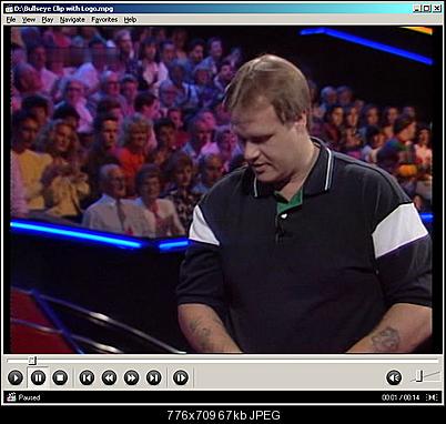

  1. I had a video that had dropouts which caused white lines to appear on the video and I used a script to remove the lines which basically just guessed the pixels that should be replaced. Can someone please suggest a similar script which can remove TV logos? I've attached a source clip. Also attached are 3 videos. The Challenge Logo video is the video logo sample used to remove the logo. One of the videos is the encoded result when using a video as a sample and the other video is the encoded result when using an image as a sample. I've done cleanup on the encoded videos. Cleanup was done after the logo script.
    Tried this script:
    LoadPlugin("C:\Program Files (x86)\AviSynth 2.5\plugins\Logo Removal\LogoTools\LoadPluginEx2.dll")
    LoadPlugin("C:\Program Files (x86)\AviSynth 2.5\plugins\Logo Removal\LogoTools\LogoTools.dll")
    B=ImageSource("logo.bmp").ConvertToYUY2(Interlaced=true)
    A=MPEG2Source("E:\Bullseye Video Source to Encode.d2v").ConvertToYUY2(Interlaced=true)
    NoLogoAuto(A,B,1)
    It works but the frame number is actually for the image and it doesn't matter what frame number you use as the image is not a video so it only has 1 frame. Regardless the script works but it leaves a visible mark behind on black scenes.
    I tried the below which gets better results. It looks for a frame in a video sample which is all black apart from the logo.
    clip=MPEG2Source("E:\Bullseye Video Source to Encode.d2v").ConvertToYUY2(Interlaced=True)
    logoclip=MPEG2Source("E:\Challenge Logo.d2v").ConvertToYUY2(Interlaced=True)
    NoLogoAuto(clip,logoclip,80)
    ConvertToYV12(Interlaced=True)
    Frame 80 is from logoclip which contains the logo sample.
    This video looks better than the image version but it still has some frames where the logo remains are still visible. On dark scenes or complex pattern scenes you can't see the logo but on lighter scenes you can see it. Is there anything else I can do to remove the remains of the logo?

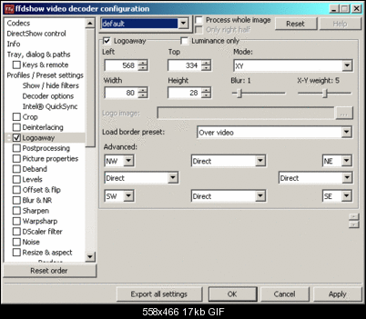

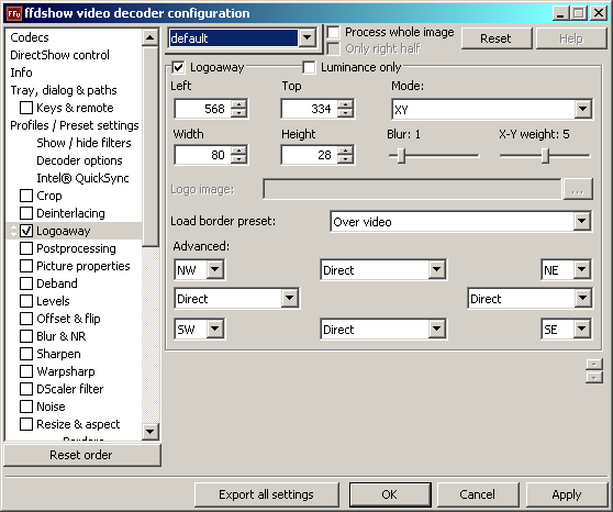

    In order to set it up, I open the source video with MPC-HC and get ffdshow to decode. That way it's easy to get the placement correct and see how it'll work before using it in a script (if you crop or resize you'd need to add ffdshow to the script first or it won't be in the same position as it is when viewing the source video with MPC-HC).
    There's a few different logo removal methods. One involves creating a bitmap image of the logo being removed which I'd assume should give the best result. I'd imagine it's the same method as described here. I just use the XY mode myself.
Name:	ffdshow logo removal.gif
    Very roughly, left 52, top 38, width 92, height 30, XY mode (ugly blob mode ).

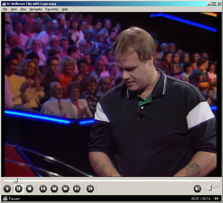

  3. Thanks but that screenshot has a blurry mark where the logo was which is just as bad as the logo! I'm looking for a script that guesses the pixels that would be in place of the logo if the logo wasn't there.
