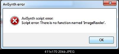

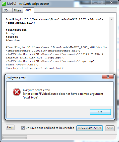

    Hello, I'm currently trying to input a watermark on my video along with hard-coding some subtitles to my .mp4 video. However, I keep encountering this problem as shown in the image attached below when I click "Preview AVS Script".
    I have absolutely no problem viewing the video before and after attaching the subtitles, but when I edited the script to input the watermark, the error keeps popping up.

    I have tried installing:
    i) http://www.avisynth.nl/users/warpenterprises/ (remapframes_25_dll_20050826 and imagesequence_20101115 )
    ii) https://www.videohelp.com/tools/ffdshow
    iii) https://www.videohelp.com/tools/Haali-Media-Splitter
    Below is my script:

  2. ImageReader() should come default with avisynth install
    Try replacing it with ImageSource()

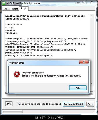

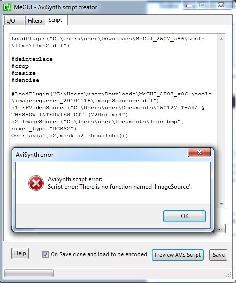

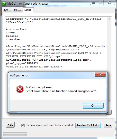

    I've tried copying that and also trying the 3 variations (ImageSource, ImageReader, ImageSequence) but the same error still persists

  6. Originally Posted by vancew90 View Post
    Copy & paste the 2nd version of the script above. Post any error messages verbatim
    It's not possible or you're not reporting what is happening correctly - Does the error message change? For example, if you call ImageSource() it won't give you an error regarding ImageSequence() . It will say something about ImageSource()
    Since FFMS2 is working, you can replace with FFVideoSource() for a single image logo as a workaround until you fix your setup. This won't load an image sequence.
    This assumes that your logo is RGBA (transparent)
    LoadPlugin("C:\Users\user\Downloads\MeGUI_2507_x86 \tools\ffms\ffms2.dll")
    a1=FFVideoSource("C:\Users\user\Documents\150127 T-ARA @ THESHOW INTERVIEW CUT (720p).mp4")
    a2=FFVideoSource("C:\Users\user\Documents\logo.bmp")
    Overlay(a1,a2,mask=a2.showalpha())
    Or, you probably need to install avisynth. I think some versions of megui have a "portable" avisynth install or something like that it might cause problems
    Yes, the error varies according to the codes that I have tried.

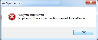

    I've tried replacing my previous version of avisynth (2.5.8) with the latest one (2.6.0) but I still get the same message...
    And yes, my image file is transparent.

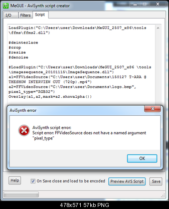

    Alternatively, I've tried the newest code that you had given me:
    But instead, this error pops up:
  8. Erase the "pixel_type" . Re-read/ copy the post again. You probably copy/pasted it before I made a quick eit
    Feb 2015
    Singapore
    Oh yes, it worked like a charm! Thank you so much! But one more thing: This is my current code:

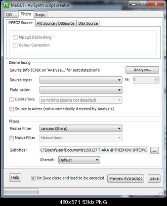

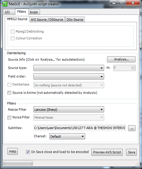

    Despite this, the subtitles don't show up when I click "Preview AVS Script" because there isn't a line in the script that inputs the subtitles right? I've tried TextSub() but it says "There is no function named TextSub."
  10. You need to load vsfilter.dll for TextSub()
    LoadPlugin("PATH\vsfilter.dll")
    Where "PATH" is the actual directory path
    These observations suggest that you have other problems with your avisynth configuration. Do you have avisynth installed on the system? Or is it a "portable" megui version ?
