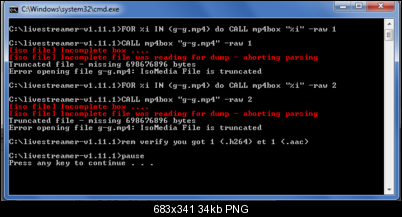

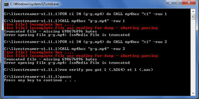

  9. Ok will give that a try and report back and how it goes. Installing mp4box as we speak.
  10. Click image for larger version
    The results of running that batch file.
    So it looks like I was right on there being some bytes missing. I tried downloading a few episodes from tubi tv via the program "Allavsoft" and the videos done via that suffer from the exact same issue. Very odd.
    It's as if the site itself has setup their video files to be incomplete, but yet totally viewable fine from the site itself. That's just my guess.

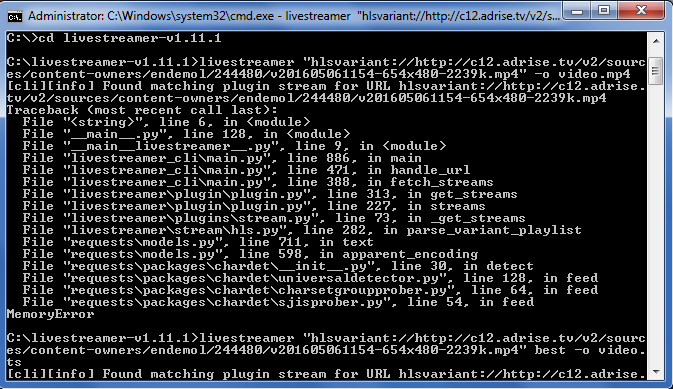

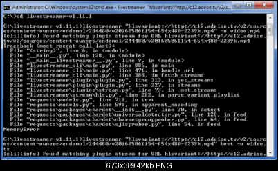

    I tried putting that in as just:
    livestreamer "hlsvariant://http://c12.adrise.tv/v2/sources/content-owners/endemol/244480/v201605061154-654x480-2239k.mp4" -o video.mp4
    But got this error message from livestreamer:
    Was there a different way I had to put that in, rather than what I used?
  14. Member Emeritus
    May 2014
    Livestreamer isn't necessary, although you can use it if you absolutely have your heart set on it.
    You can just paste the url into your browser (chrome) and then right-click on the page and choose "save as".
    If using livestreamer, use the httpstream plugin:
    livestreamer "httpstream://c12.adrise.tv/v2/sources/content-owners/endemol/244480/v201605061154-654x480-2239k.mp4" best -o v201605061154-654x480-2239k.mp4
  15. I was just using livestreamer as the site using geolocking to prevent people outside the US from accessing the site. VPN gets around that.
    Is there others that work fine?
    And dayam that fixed it completely. The file downloaded works perfectly. Thank you very much to all .

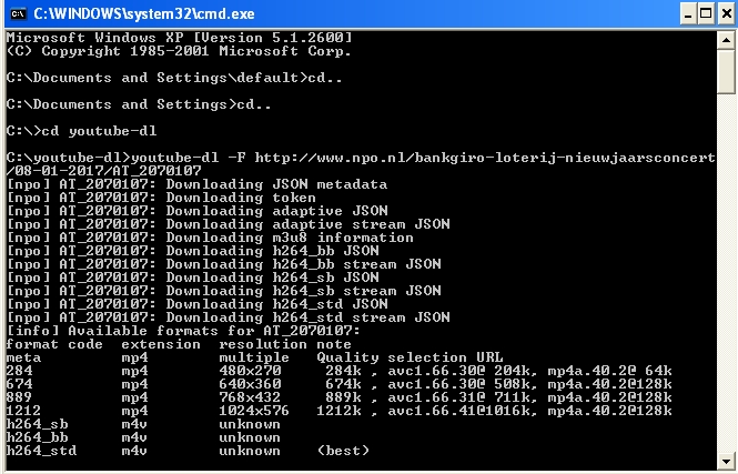

  18. http://www.npo.nl/bankgiro-loterij-nieuwjaarsconcert/08-01-2017/AT_2070107
    I used youtube-dl with the g command.
    template:
    youtube-dl -g url of video
    final command to get url of video:
    youtube-dl -g http://www.npo.nl/bankgiro-loterij-nieuwjaarsconcert/08-01-2017/AT_2070107
    youtube-dl gives this http url (see screenshot 1) which can be used to download the video:
    http://content10c5c.omroep.nl/urishieldv2/l27m5d8d90714efec73e005872e6d7000000.6a92e539bfe2d946d861169cb4abfca8/ceresodi/h264/p/26/10/10/2e/std_AT_2070107.m4v
    Put this in Firefox browser to download a 564MB file. (See screenshot 2)
    Link to youtube-dl that I used:
    http://files.videohelp.com/u/61125/youtube-dl.zip
    You can also use the F command (gives available resolutions).
    Template:
    youtube-dl -F url of video
    command to get available resolutions:
    youtube-dl -F http://www.npo.nl/bankgiro-loterij-nieuwjaarsconcert/08-01-2017/AT_2070107
    A list of available resolutions is listed (see screenshot 3).
    I choose
    674
    which is 640x360
    Template:
    youtube-dl -f resolution url of video
    final command to download video:
    youtube-dl -f 674 http://www.npo.nl/bankgiro-loterij-nieuwjaarsconcert/08-01-2017/AT_2070107
    During downloading you can press
    ctrl c
    to stop the downloading before it's finished. You can play the partial download with Media Player Classic Home Cinema

    C:\Documents and Settings\default>
    Before you paste in a youtube-dl command, you need to navigate to the youtube-dl folder so that you see this:
    C:\youtube-dl>
    I use the
    cd..
    command twice to navigate up to the C drive and then the
    cd youtube-dl
    command to navigate inside the youtube-dl folder.
    Then you can paste in a youtube-dl command to use the software. Look at the following 5 lines:
    C:\Documents and Settings\default>cd..
    C:\Documents and Settings>cd..
    C:\>cd youtube-dl
    C:\youtube-dl>paste your youtube-dl command (blue color) here
    example:
    C:\youtube-dl>youtube-dl -F http://www.npo.nl/bankgiro-loterij-nieuwjaarsconcert/08-01-2017/AT_2070107
    See screenshot 2

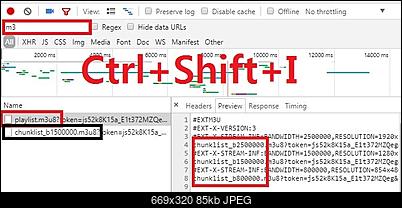

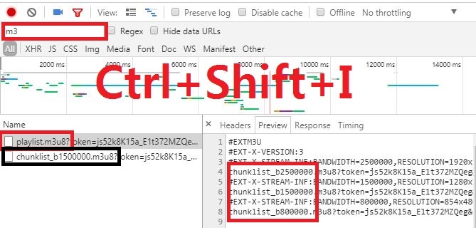

  28. Originally Posted by nagra View Post
    Hi!
    Please help me to download this video at this webpage...
    http://boba.ettoday.net/video/4/307/43564
    Open the page in Chrome, then Ctrl+Shift+I to open the developer tools. Click on "Network".
    Type "m3u8" in the search box, then playlist.m3u8 and chunklist_bxxxxxx.m3u8 will appear.
    Right click on chunklist_bxxxxx.m3u8 and copy the url.
    Click on playlist.m3u8 to check the available resolutions of the video.
    you can replace "xxxxxx" from the copied url to change the resolution of the video you want to download.
    1920x1080 : 2500000
    1280x720 : 1500000
    854x480 : 800000
    ffmpeg
    ffmpeg -i "the url you copied" -c copy output.ts
