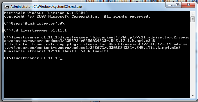

  1. Originally Posted by icemann View Post
    Thank you very much biezom. I followed what you said for another user earlier in the thread by downloading livestreamer and placing it in C:\, then I used the code:
    livestreamer "hlsvariant://http://c11.adrise.tv/v2/sources/content-owners/endemol/225672/v0206024322-,545,1711,k.mp4.m3u8"
    I then get this result:
    [Attachment 32665 - Click to enlarge]
    Is there an extra step I need to do after that?
     livestreamer "hlsvariant://http://c11.adrise.tv/v2/sources/content-owners/endemol/225672/v0206024322-,545,1711,k.mp4.m3u8" best -o Thou_Shalt_Aspire_To_Be_Charming.ts
    in red quality choice
    in blue file output option
  2. FANTASTIC .
    Thank you so much. Text doesn't describe properly my thanks. But thank you.
