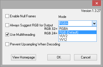

    Originally Posted by ValentineStone View Post
    how do I switch between RGB24 and RGB32 in Lagarith settings when I record RGB (not RGBA)?
    Switch between RGB32 and RGB24 here:
    Image Attached Images
    RGB32 = RGBA
    RGB24 = RGB (Default)
    ^ Well, that is what I guessed, and I see the point that extra 8 bits are there for transparency, therefore 32 is 24 collor + 8 for alpha, but why then Lagarith's page here states that it can do RGB24 AND RGB32 AND RGBA?:

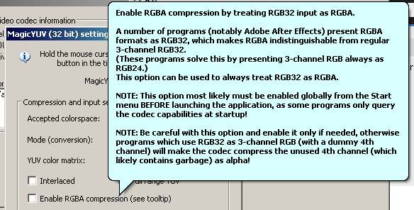

  7. MagicYUV does a bit of RGB32 and RGBA distinguishing I don't really understand.
    http://magicyuv.com/index.php/features
    Or maybe someone can reverse engineer the RGBA tooltip into English.
    It distinguishes between RGB32 and RGBA in the list of input colour spaces, but I don't quite understand why.
    So it'd appear RGB32 is often really RGB24 with a dummy alpha channel, but when is RGB32 really RGB32?
    It's described here as having a greyscale colour channel. Is that the distinction between RGB32 and RGBA? Greyscale colour channel vs a transparency/alpha channel?

  16. Ignus,
    Looking at my screenshots in post #7, if I select RGBA as the accepted colourscpace, do i still need to check the "enable RGBA compression" tooltip, or would it be treated as RGB32 until the option is checked?
    Thanks.
  17. Originally Posted by hello_hello View Post
    Ignus,
    Thanks.
    Yes, you have to select.
    If you select RGBA as the accepted colorspace, but don't check Enable RGBA, then the input is treated as RGB32, which will not be accepted, since it's not RGBA. You can try in VirtualDub, it will refuse to compress this way.
    Yes, this really can be a bit confusing, but works sort of like a double check: you enable RGBA compression (treat RGB32 as RGBA) and allow only RGBA compression (accept only RGBA/RGB32, and not RGB24 for example).
