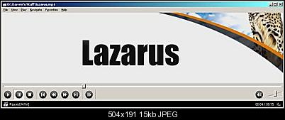

    Here's how your sample looks to me:

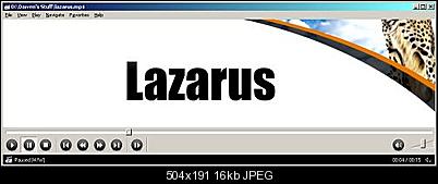

    Here's how it looks after the levels have been converted from full range to limited range:
    If that's the difference you're seeing then I think the video needs to be converted to limited range levels when it's encoded. Where it's currently displaying "pure white" at the moment, that will be the times it'll display correctly after it's converted. The times when at the moment it looks right, it won't look right any more (maybe a bit washed out), because they're the times it's technically not being displayed correctly (the levels aren't being expanded).

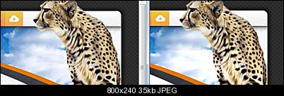

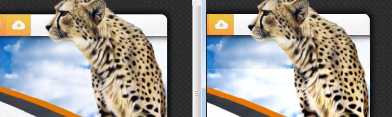

  3. Since your video is full range YUV try flagging it as such. bt470bg (usually used for standard definition) or bt709 (usually used for high definition). Comparing flagged bt709 to the unflagged original in Firefox:
