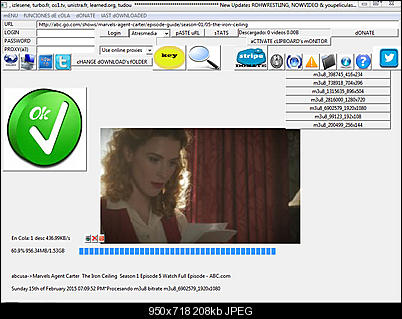

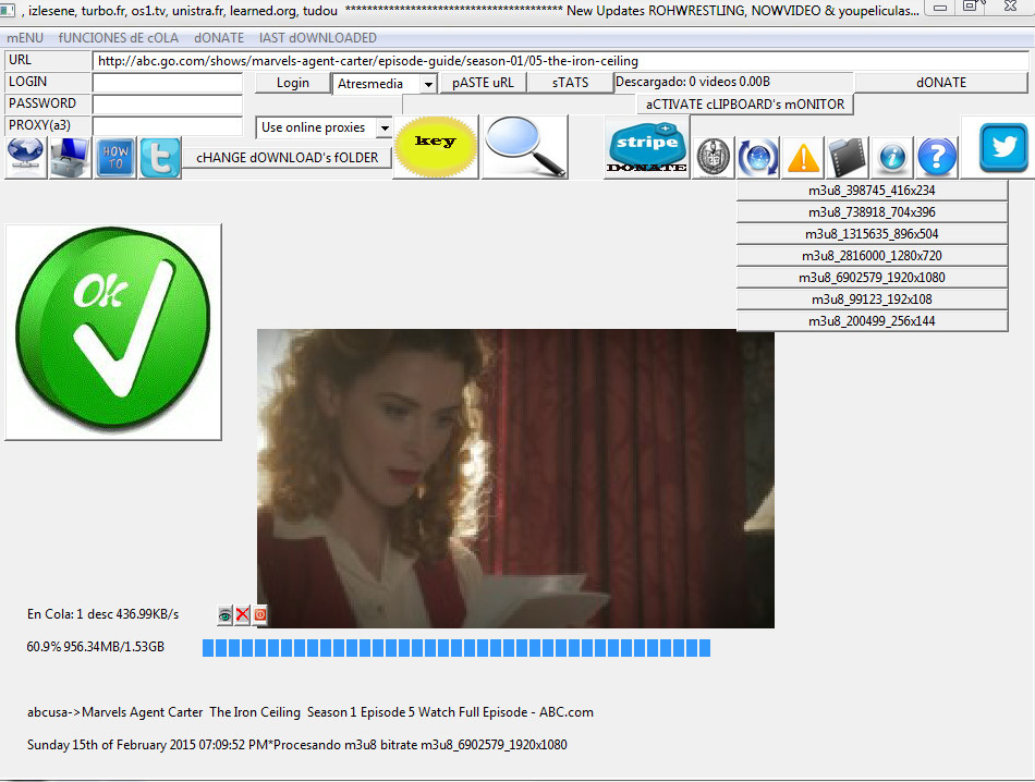

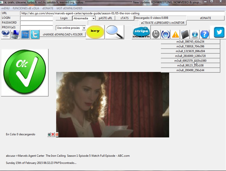

    Thank you rbl82 for you suggestion. I downloaded the software, entered the URL but cannot get it to do anything. The "Help" instructions are in Spanish so I can't get anything from that. It just sits there with a large "Waiting" box on the left side where you show a check
    Aug 2006
    Paste the link for the webpage containing the video into the URL text box.
    Click on the magnifying glass icon
    Wait for the "Processing" icon to change to "OK".
    Pick from the list of m3u8 links that appears on the right side of the window. (The resolution for the download is part of the text.) After that the download will start.

    Thank you rbl82 for the clear instructions. There is still one thing I don't understand about selecting the resolution from the list. What do you mean that it's part of the text? Does it say somewhere what the best or "correct' resolution for a particular download should be?

    I mean that clicking on "m3u8_6902579_1920x1080" downloads video with a resolution equal to 1920x1080. That would be the best one for most people, unless one intends to play the video on a device that only accepts video with resolutions up to 1280x720. In that case they would want to click on "m3u8_2816000_1280x720".
  15. Member Novice20's Avatar
    Apr 2011
    New York
    Thank you usually_quiet for clarifying that. I apologize that i didn't realize that you had made the previous post.
    I'm watching the folder into which it is doing the download. It is less than half done and it has already created over 250 files of 2.5K each (MPEG-2 TS Video) and over 300 "crypt-nnn.key files. Is this what it's supposed to do? If so, how do I play this once it's done?
    Thank you
    Aug 2006
    Thank you
    Downloads are usually sent in pieces. atresdownloader will join the pieces to create a single file containing the entire video when the download completes. You can delete the leftover bits afterwards.

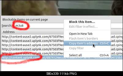

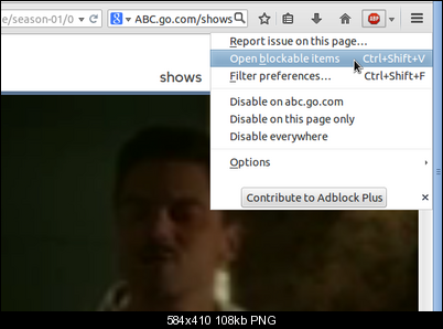

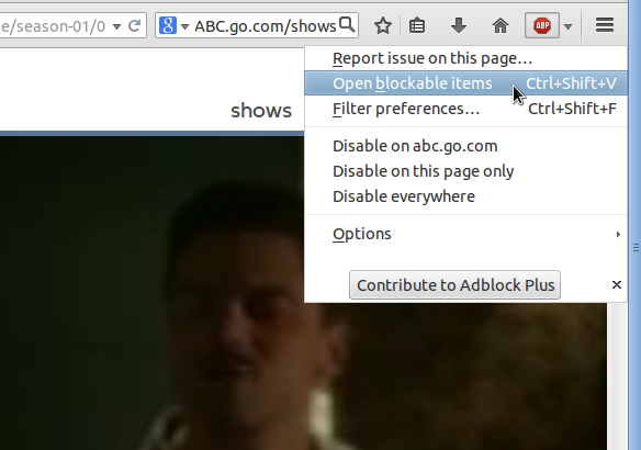

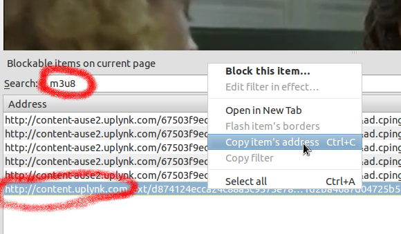

  24. hello
    you can use adblock plus addon on firefox and livestreamer
    1) install adblock plus firefox addon
    2) start the video
    3) click ABP icon click Open blockable items
    4) search for 'm3u8' (without ' ')
    5) copy the url
    we have an url that looks like this
    http://content.uplynk.com/ext/d874124ecca24c88a3c9575e78686acf/10030060.m3u8?exp=.............&ct=a&eid=.........&oid=...................&iph=.......&rays=........&euid=.......................&sig=.................&ad.cping=1
    with numbers and/or letters in place of ......... (for each launch of a video, the numbers and letters are different)
    6) close the video (important)
    7) use the url with livestreamer
    livestreamer "hlsvariant://http://content.uplynk.com/ext/d874124ecca24c88a3c9575e78686acf/10030060.m3u8?exp=.............&ct=a&eid=.........&oid=...................&iph=.......&rays=........&euid=.......................&sig=.................&ad.cping=1" best -o MarvelsAgentCarterTheIronCeilingS1Ep5.ts
