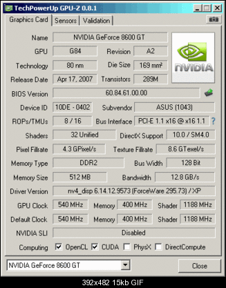

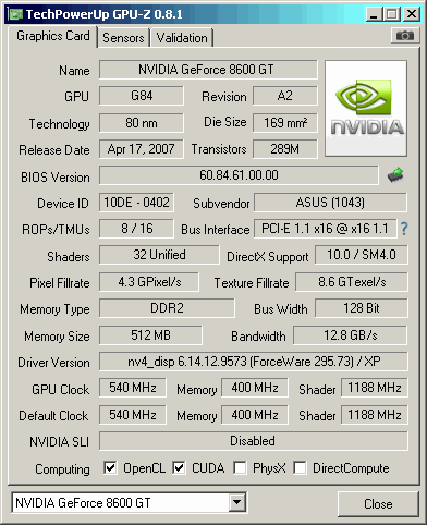

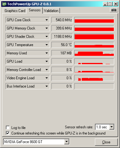

    For some reason it only just occurred to me to consider thinking about remembering GPU-Z, but as I did, I gave it a spin. "Video Engine Load" seems to be the relevant one. When I played a random 1080p video, it jumped to 50%, otherwise it seems to just sit on 0%.
ID:	30187Click image for larger version
    Edit: Odd...... I would have bet a large sum of money my video card has 256MB of RAM, but according to GPU-Z it has 512MB. I guess my memory isn't all that wonderful.

    I found this, and if it's correct, you might be out of luck, because for your card it says it doesn't support "H.264 Decode Acceleration with IDCT and CAVLC/CABAC", so are you sure it's actually working?
    At the moment I said I got H/W acceleration working I didn't know about GPU-Z, I played again the video and GPU-Z showed 0% under GPU Load and Video Engine Load, now I'm guessing that the 70% of CPU usage has something to do with the older DXVA decoder from MPC-HC v1.6.6.
    @ all
    I know that I might end up buying a new graphic card but it's strange that not even MPEG2 acceleration works for my system, my D915PGN features latest BIOS and the only thing I modified was the Boot options, other configurations are with default values, should I change something else to get H/W acceleration working for my card?

    @ all who are not giving me the advice of buying an all new PC
    I'm still curious about why I've not been able to get H/W acceleration for my card for any type of format but I've got an update:
    Last night I installed Cyberlink PowerDVD 14 and with default settings playback was worse than what I've been getting from MPC-HC but I changed the settings from ''using H/W decoding if possible'' to ''use software decoding'' and CPU usage was always around 90% but playback was perfect!, that's not still what I need 'cause sometimes reached 100% but maybe this means something to you, for me, being a newbie without the required knowledge to clearly understand what's happening my guess is that Cyberlink PowerDVD H.264 decoder is better but are your opinions what I want to hear!
