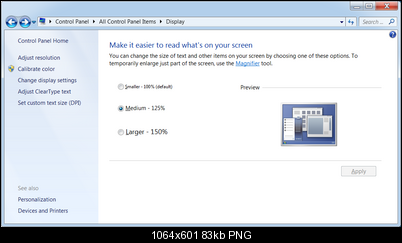

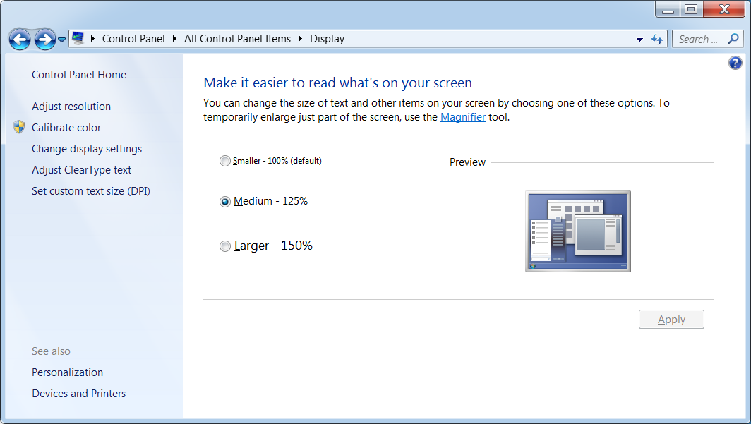

  5. Originally Posted by cornemuse View Post
    Any way to make text larger? (in 'properties' I increased the windows text size, but menu & dropdowns are still very small).
    Using this dialog?
    Yes, some screen text isn't enlarged by that. Do you know about the Magnifier? Start -> All Programs -> Accessories -> Ease of Access -> Magnifier. I have my middle mouse button set to bring that up. That lets you zoom in by a chosen amount.
    You can also try setting the graphics card to a lower resolution. The monitor will usually zoom or stretch the incoming lower resolution to its native resolution. In the Advanced section you will probably see a "List All Modes" button. That may show more options than the standards. Selecting a resolution that's have your monitor's native resolution often works well in terms of readability (not so well in terms of things fitting on the screen). But with a 1600x900 monitor that's probably not possible. Try 800x600 and look for a setting on the monitor that tells it to zoom (thereby keeping the correct aspect ratio), not stretch.
