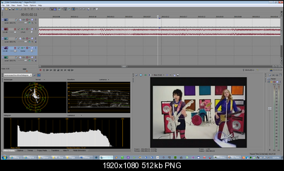

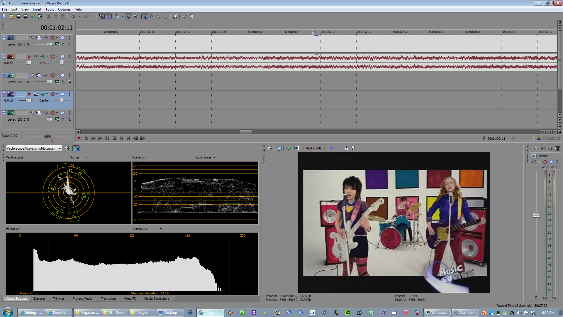

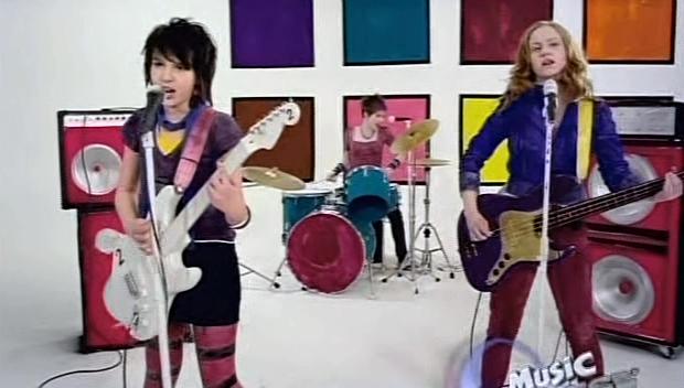

    This is a screenshot of the original 720x480 (resized to 656x480 to achieve square pixels and maintain the whole image without cropping)
Name:	_Color Correction_1.png

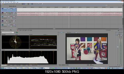

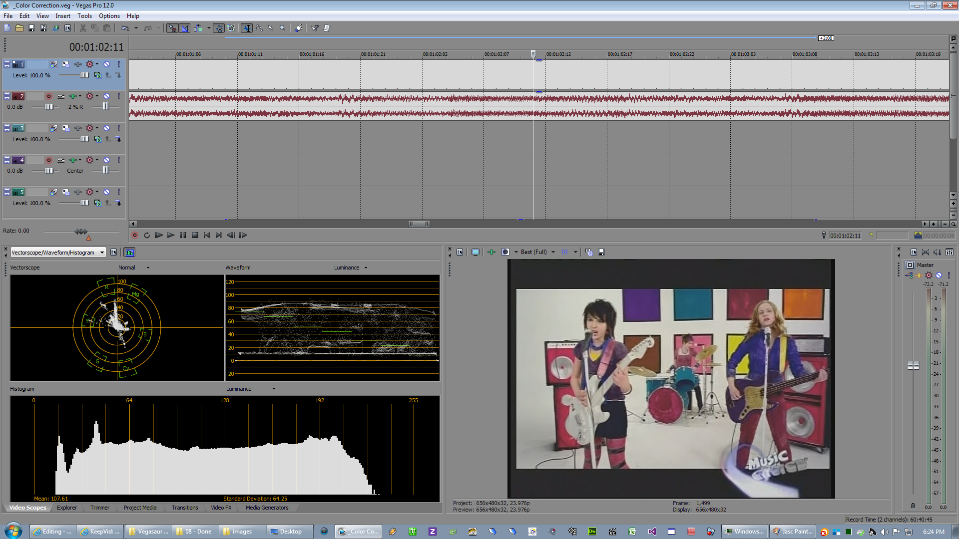

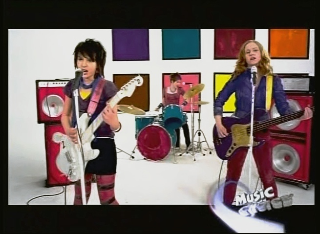

    This is the modified image.
Name:	_Color Correction_2.png
    Steps:
    1. Add Sony Levels plugin to Video track I'm working on and
      a.) adjust the Input start to lower the Black levels down to approx. 0 on the Waveform monitor
      b.) adjust the Input end to raise the Whites to approx. 255 on the Histogram monitor
    2. Add Sony Levels plugin to Video Output FX and apply a "Computer RGB to Studio RGB" preset (to apply the effect to the final output) to change the color range from 0-255 to 16-235.
    I'm wondering if someone could take a look at this and make some recommendations (I learn more from watching what people do than reading about it, sorry)
    The final output video is either .mp4 or .mkv (both x264 codec, depending on whether the video will be streamed, have chapters/subtitles, etc.)

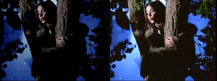

  5. Member budwzr's Avatar
    Apr 2007
    City Of Angels

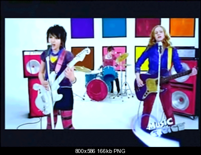

    A simple "Levels" adjustment is a start.
    LEVELS ADJUSTED
    KNOCK DOWN BLUE HILIGHTS A TAD
    ORIGINAL

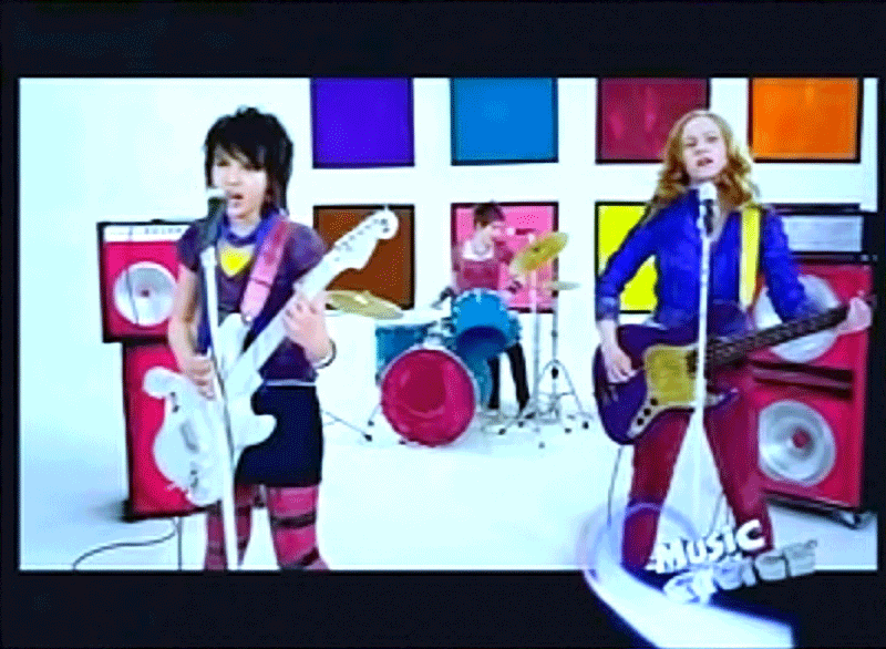

    Basically there are two steps in color correction.
    First step is to get it correct. Levels, gamma, color accuracy etc. This is pretty much a science.
    Second step is the creative part where you want to play with the thing and present it to your liking. This is art, there is not a right and wrong answer here.
    When I look at this video I get a "70s colorful plastic Bay City Rollers Warhol" feel about it, so I would probably 'bleach' the whites and colorize the thing some more, like so:
    ORIGINAL
    But again that's just an idea, there is no right or wrong about it.

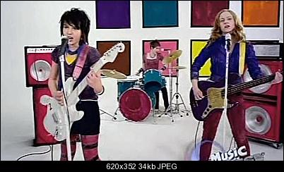

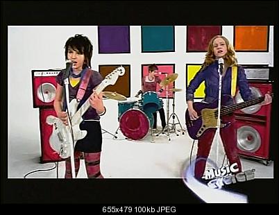

    @ziggy1971, I think you see the problem with working with screen captures. We'd prefer to see a piece of real, unprocessed video. The work we might suggest for these nearly unworkable screen captures would hardly be effective on the real thing.
    I'm not sure what that's about. 656x480 is a 1.37:1 image ratio. Is that what you wanted? The image as shown has some chroma bleed, halos, and icky artifacts in some areas that might have been the result of resizing or other processing. If you are doing all this processing in the original compressed format, you're dirtying up your video.

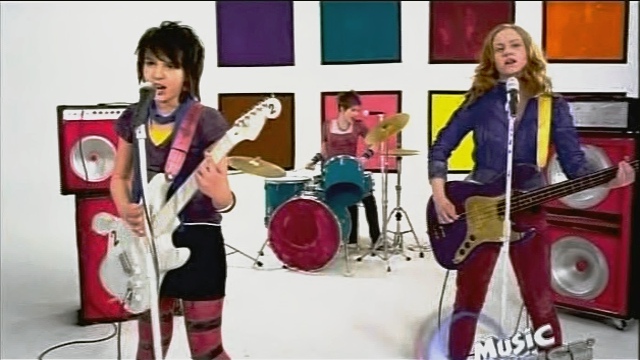

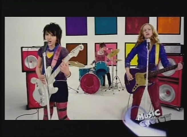

    The original pic, from the bottom image you posted. Looks dim and washed out, but not as bad as the top image. Is the top image what the original video really looked like? In your lower modified image gamma looks rather odd (Did you use brightness and contrast controls to alter this image?Don't do that any more. Use better tools). Blue looks oversaturated in the blouse of the gal on the right. Red also has a lot of noise in it. I'd think you need some cleanup before you start playing with color.

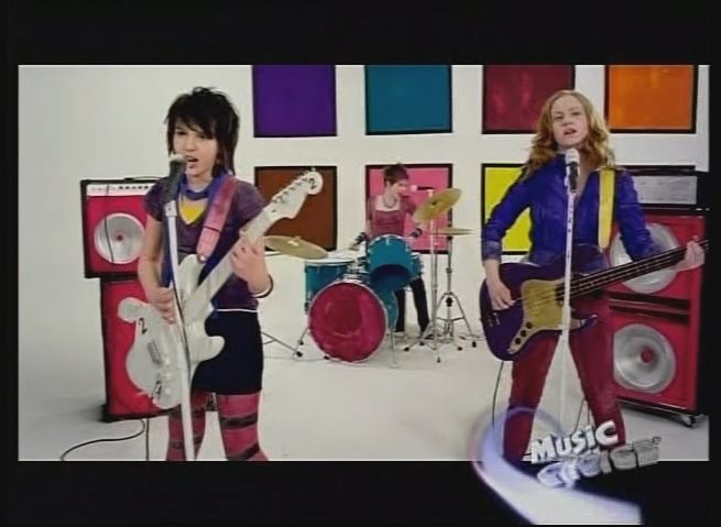

    Like others said, you can make it look however you want (assuming you have the real video, not a screen cap). I came up with the mods below:
    I don't use Vegas (I tried Vegas 9. Ended up with After Effects and a different encoder). The above might not be what the video is supposed to look like -- owner discretion advised, and we've never seen any of the original video to work with. I used AfterEffects Levels and Color Finesse for this, but Vegas has similar controls. Began by using a curves filter to set levels and color balance for blacks, grays, and whites. Pure bright white backgrounds tend to distract, so I set white point at RGB 230 (other color work will modify that a bit), and toned it down a bit later. But you can make it brighter if you like. With the Hue/Saturation control I lowered blue saturation. lowered Red contrast but raised middle Red saturation a little, and raised yellow saturation by about 8%. The rest was with an added curves filter and a Levels control to work with shadows and midtones, lowering the initial midpoint from 128 to about 115, which improved skin tones.
    Maybe take a look at the books linked earlier. They'll save years of scouring thru web tutorials that5 won't teach you that much. Stay away from Brightness/contrast filters. Calibrate your monitor. Try to submit a piece of real, unfiltered, unresized video next time; screen caps are a pisser.
    And you're right: you learn from others and by doing it.

    640x480 is 4:3 (aka 1.33:1). 656x480 is not 4:3. It's 1.367:1, which is wider than 4:3.
    The image that's inside the black borders loooks like it would be 16:9 (1.7778:1), but it's not that wide. It's 1.74:1, which is more narrow than 16x9. Whatever....a piece of the original would tell us more.
    Most new TVs allow you to disable overscan, which prevents cropping. Overscan is usually enabled by default.
    It's permissible to make a short 10-second cut of video that you own, for educational purposes. Most MPG cutters will cut only on key frames, but that's not a problem in this case. You can use mpg2cut2 or DGIndex, both free. 10 seconds of MPG with motion should be enough and would be well within posting size limits here.

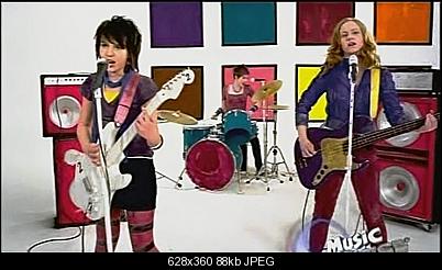

    [EDIT] Ooops. Forgot. For what it's worth:
    upper image: with borders cropped, image in frame is 628x360, or 1.74:1.
    lower image: borders cropped, image as 1.777:1 (640x480, or 16:9).
Name:	image 628x360.jpg
Name:	image 640x360.jpg
    Compare the drum in the middle and the speaker on the left. You can leave the side borders if you want, but the resulting image displays at the wrong aspect ratio.

    Yeah, Newp, your "Bleach Bypass" is horrendous. (No Offense)
    This one by LMotlow is very good.

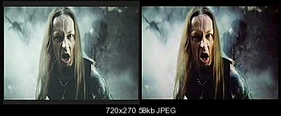

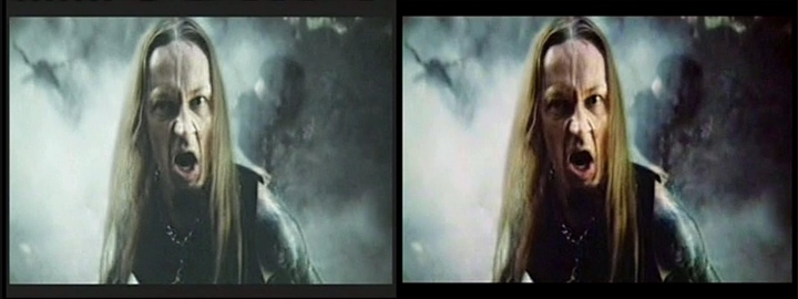

  18. I dis something similar to LMotlow early this morning using AviSynth. I didn't saturate the colors as much though.

    This is what I did after cropping the picture out of the Vegas screen cap:
    ImageSource("_Color Correction_1.png")
    ConvertToYV12() # work in YV12
    # for dark areas: only correct levels
    darks = ColorYUV(cont_y=100)
    # for bright areas: adjust levels, saturation, white balance
    brights = ColorYUV(cont_y=100, cont_u=100, cont_v=100, off_u=7, off_v=-3)
    # replace bright areas with white balanced video
    Overlay(darks, brights, mask=darks.GreyScale().ColorYUV(cont_y=100))
    MergeChroma(aWarpSharp(depth=20)) # sharpen chroma
    ChromaShift(c=2) # shift chroma 2 pixels to the right
    The general idea is that dark areas and bright areas need different treatments (in YUV). So one stream is created with adjustments for dark areas, another stream with different adjustments for bright areas. Then the two are blended together using a brightness mask to control which areas get which treatment. The ChromaShift(c=2) might be too much but with YV12 you can't shift by one pixel.

    Yep. Rough stuff. Look like re-encodes. The bitrate on both samples is way too low for the material, and makes the Bjork clip look soft. Got some terrific noise problems everywhere, and the low bitrates don't help:
    Frame 359 of the original "Bjork" with darks lightened:
Name:	frame 359 original darks lightened.jpg

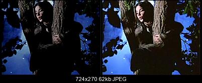

    I didn't try to clear the noise or the weird frame blending -- that would be a whole different story. I touched on levels and color. Darks are crushed and/or highlights blown out in both samples. There's only so much you can retrieve with invalid video levels. The "Ghost" smple would need work scene-by-scene, no time for that now.
    Top image: "Human Behavior", frame 2700 before/after. Bottom image: "Ghost Driver", frame 3166 before/after.
    The attached mkv's are demos with about 1/2 the original scenes removed. I added a fade-out/fade-in between cut sections. I played with jagabo's script and a few other tricks, but it was more handy to use some "quickie" Avisynth plugins. Even with the noise cleared, you'd need more bitrate than I used here.
    - My sister Ann's brother
