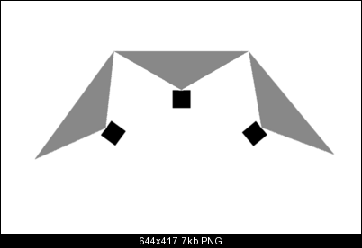

    @LankyActor, I think you will find that your shooting arrangement is doing you a disservice. 3 cams shooting side-by-side parallel might be useful for a few stereoscopic effects, but you will encounter overlap & repetition in the image if you pan across 3 images. This problem becomes particularly glaring if you have something in the foreground. Exception: the cams are spaced V__E__R__Y.......F__A__R.......A__P__A__R__T.
    In that way, in essence you are removing any overlap.
    The proper way to get what you were intending would be to shoot at angles that subtend an arc of a single "virtual camera" which is behind the 3 cams. Here is an example:
    Then, the aforementioned AVISynth technique would work VERY well indeed.
