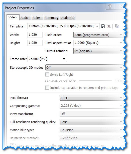

    I have a nikon D3200 and it shoots .mov. I shoot at 24 fps as it says it gives a more film like look. The film is for a DVD for people who have DVD players. I want as good as quality as possible
    So if i load the .mov and also jpegs what is the best render for A DVD as high qulaity as possible.
    There is also the possibility it will be played in public. What would be the best to render for that. It would be either on a large TV or fed from a computer to a large screen. Sorry cannot give more details on that it is not finalised. Just assume it is for DVD for the moment.
    I can make different versions by loading the.veg and rendering different settings?
    Thanks for your help

    As explained by Cornucopia, if you change the camera's output video standard to PAL the frame rates 25 and 50 will become available for shooting.
    25 fps look just as "filmic" as 24 fps but you avoid the need to convert to 25 fps later on. I think it's really a good idea to shoot at 25 fps in the future.
    Originally Posted by Dopey2013 View Post
    Is this bad and if so how could it be made better.
    Increase the bitrate. That's very easy and it'll help. Increase the video bitrate to like 25,000 KBit/s (5 times as much). Regarding the audio, use a higher bitrate too. You can easily pick the highest available (should be 448 or so).

    OK thanks. I just noticed the bit rate mode is variable, That is bad is it?
    good tip thanks
    50 fps is 1280x720
    24 and 25 fps is 1920x1080
  22. Originally Posted by Dopey2013 View Post
    Variable bit rate is fine. Variable frame rate is bad.

  28. Can i render as in screenshot and burn to DVD?That would be HD burned as SD? I thought i had uploaded this but do not see it. Apologies if uploaded twice

  30. Please read this carefully and try to understand, I'm not sure you do this through out this thread ...
    It is very difficult to read what you actually want, that first setting of yours is PROJECT properties, not EXPORT properties, not even DVD size etc., when you export video you have to set correct values in export template. Some export parameters could be taken from PROJECT properties settings but video resolution, frame rate,pixel aspect ratio have to be correct in EXPORT template.
    there is I guess three ways to burn video on DVD,
    1) almost anything, meaning video file, burn it as data, but no DVD player would play it, only computers, and bitrate should not be higher than 16-18Mbit/s or so
    2) same like 1) but video is strictly by Blu-Ray specs, or at least close to those specs or format, perhaps m2ts, mts, mts, transport streams etc, or mpeg and hope that Blu-Ray player would play it, some would not. DVD players would certainly NOT play it. Maybe just some 720x576 mpeg video.
    3) you have to author proper DVD structure , that is stored in VIDEO_TS and then burn it on DVD, so all DVD players can understand it, and play it, but video resolution has to be 720x576 (for PAL DVD).
    and again ConvertXDVD imports anything and makes correct DVD structure, changing video - re-encoding video, creating number 3) DVD structure, and burns it, concentrate only for this 3) solution, ..., not 1) or 2)
    At least it is clear now that your video is 25p so no blending or slowing down needs to be done...., we were going to kill each other here, discussing what solution would be enough for you to get 24p to 25p (needed for DVD), number 3) solution ...
    So what are you actually doing, strictly number 3) solution? That is actually recommended, because 1) or 2) need Blu-Ray player and some players might not play it anyway ...
    When you go to the store and buy DVD, it is always 3) solution (getting pressed DVD not burned though), no distribution is 1) or 2) solution
