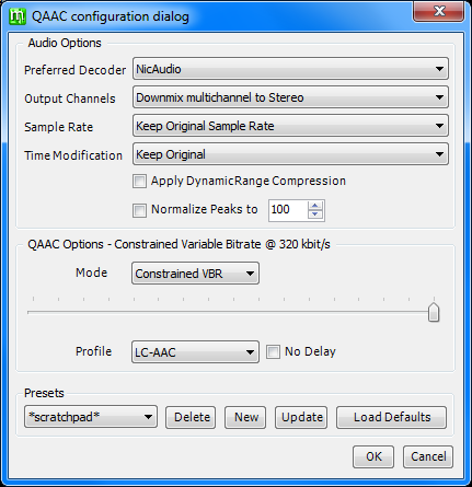

Name:	Audio encode settings.png
    Here's the uploaded scene downmixed to stereo. It's equal in loudness to the encoded file before it gets to youtube, but I have to have my volume at about 35% full. Without changing my volume, the non youtube 5.1 track sounds louder, which I guess makes sense? The 5.1 track youtube version however seems SLIGHTLY louder than the stereo youtube version.

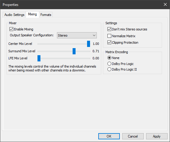

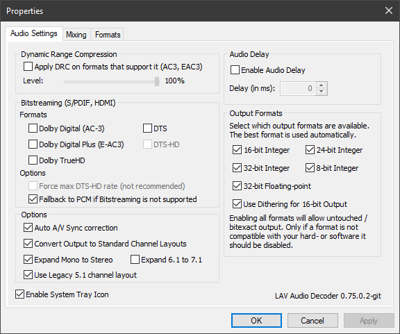

    Is there any settings in the following pictures I should change? (K-Lite Codec Pack settings)
    [Attachment 59453 - Click to enlarge]
    [Attachment 59454 - Click to enlarge]
    [Attachment 59455 - Click to enlarge]
  30. Member
    Mar 2008
    Those are the LAV audio filter screens, it doesn't look like there is anything to normalize the levels to give the gain you want.
