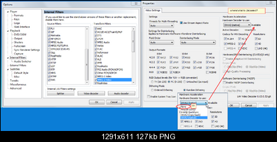

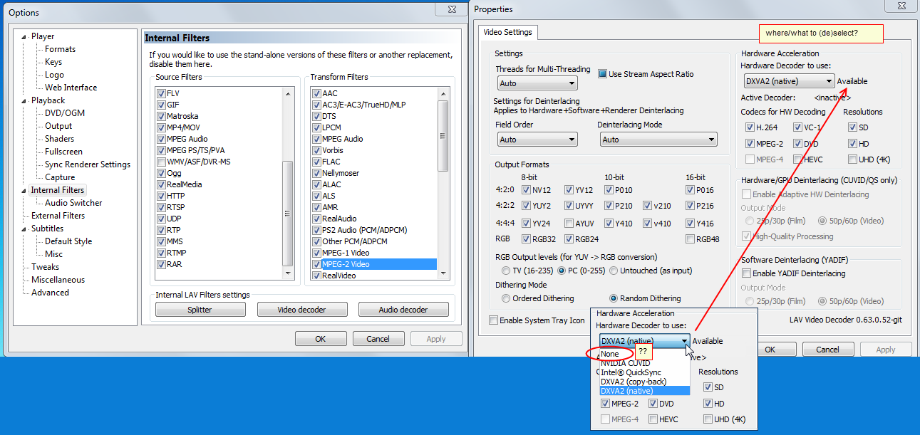

  4. Playing DVD is sometimes problematic. It may be decoder related. According to your screenshot MPC-HC is using hardware decoding (video card decoding instead of CPU). mpeg2 video doesn't take much processing power anyway, but try disabling hardware decoding before blaming the player (options/internal filters/video decoder).

    Is this the screen what you mean?
    Should I select 'none' or what..?

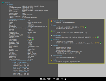

    Re your screenshot showing the list of available hardware decoders, for an ATI card I think it's only DXVA2. Rather than disabling it completely though (leave DXVA2 selected), unchecking the DVD box below should stop hardware decoding being used for DVD video. If not, try unchecking the mpeg2 checkbox also. If you change a setting there, close and re-open MPC-HC completely before testing.
    For the record, the way it works is the list of file types under Source Filters tells MPC-HC to use it's internal splitter for each one checked (the splitter separates the video and audio on playback) while the Transform Filter list tells MPC-HC whether or not to use it's internal decoders for each audio and video type. The internal splitter/decoders being LAV, which can be configured by clicking on the appropriate buttons.
    When something is deselected in the Source Filter or Transform filter list, MPC-HC will use any appropriate directshow filter you may have installed such as Haali media splitter or ffdshow or any filters/codec supplied with Windows. If none are found I think it just goes back to using it's internal filters. Unless you have a specific need you can usually just let MPC-HC use whatever internal filters are selected by default, which I think is pretty much everything except for Windows Media files.
