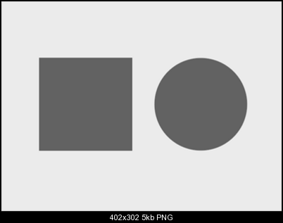

    Resize 4:3image inside a 720x480 frame for display in a 16:9 video:
    NTSC 16:9 PAR = 40:33.
    The height of the new image will be 480.
    New width will be (640 / 40:33) = (640 / 1.21212) = 528 -- or use the width for 1.36:1 video
    Add 96 pixels each side to get 720x480 and encode at 6:9 DAR.
    That's the way I've seen it done elsewhere.
    Or as jagabo suggested, 540x480. You won't get an exact 4:3 at 16:9, but it'll be close. Will be a couple of pixels off in width either way.

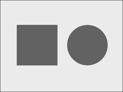

    4:3 image at 4:3
Name:	A_image 4x3 R.png

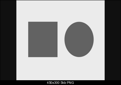

    4:3 resized to 528x480 with 96 pixels each side:
Name:	B_4-3 Resized with pilarbox R.png

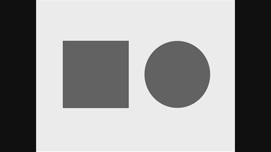

    16:9 display:
Name:	C_4-3 In 16-9 display R.png
