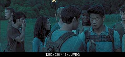

    I spent a bit of time looking through my previous test encodes. To the point where I've no idea what I'm looking at any more. I think before I run any more testing I'm going to need to find a video to encode that exhibits a noticeable loss of detail in dark areas because at the moment I'm struggling to find an example.
    Given I spent a bit of time encoding and comparing I thought I'd post an example of the result. Maybe I'm missing something and someone will be able to tell me what it is. Below are some screenshots of a dark scene. Each encode screenshot was saved as a bitmap, then I boosted the gamma for a good look at what was encoded and what wasn't. In the interest of full disclosure the "original" is itself an encode, although a fairly high quality one. And there's a slight gamma/brightness difference between the original and the encodes. That seems to be because I saved the original by opening it in a script and for some reason MPC-HC was displaying it slightly differently. I didn't bother investigating. They're all saved as jpeg (100% quality) as for the purpose of this exercise I thought lossless was probably overkill.
    Original vs CRF18 --aq-mode 1 vs CRF23, all three aq modes.
    Original

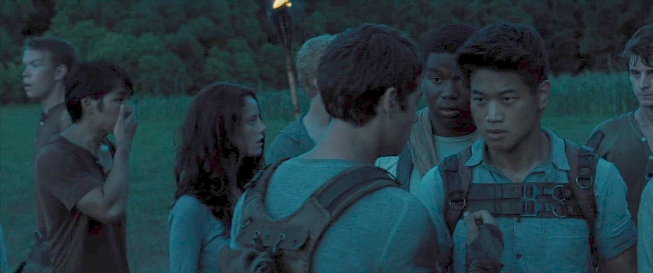

    Original with boosted gamma

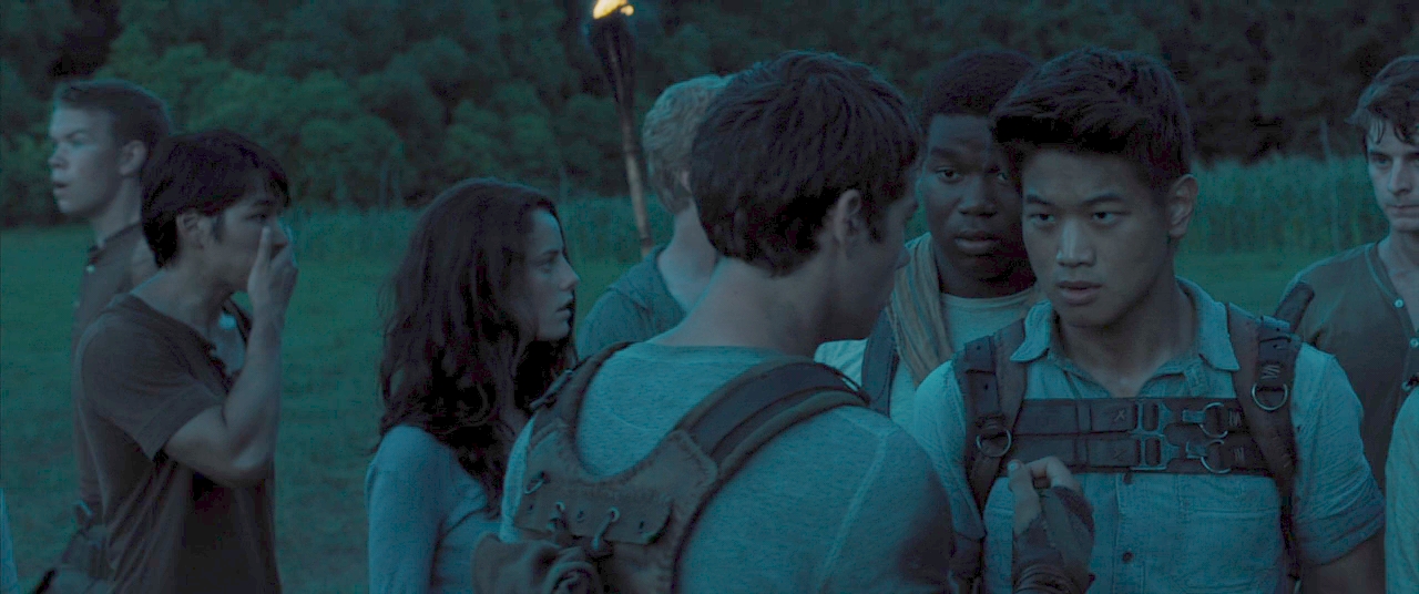

    CRF 18 --aq-mode 1

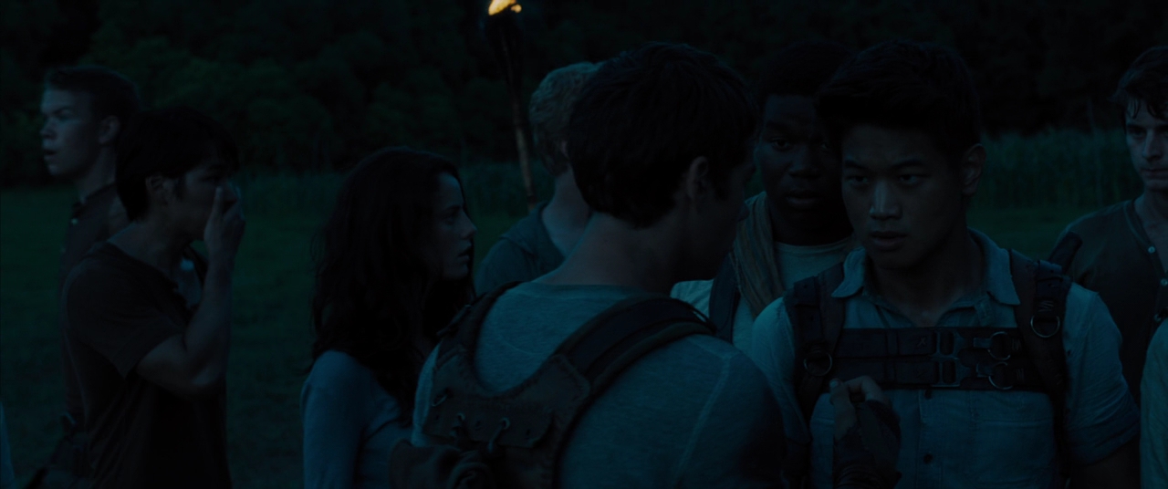

    CRF 23 --aq-mode 1

    Most of the time I thought the various AQ modes just caused the video to be encoded slightly differently, but not necessarily better or worse. Sometimes for dark scenes though, as per the example above (tell me if I'm wrong) --aq-mode 3 may have a slight edge over --aq-mode 1 (although in some areas it's better, others it's worse) and --aq-mode 2 comes last, but that's reflected in the bitrates too. And I'm not convinced for brighter scenes --aq-mode 1 doesn't look better.
    And the differences above are going to be hard to spot when watching a movie. I'm still trying to find an example of a dark scene which is noticeably lower quality under normal viewing conditions. Or maybe my TV is way off being correctly calibrated......
    I probably should get motivated to repeat the above at a fixed bitrate but given --aq-mode 3 hasn't excited me all that much yet and I generally use CRF encoding.....
