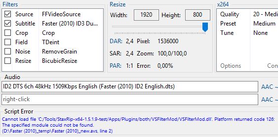

  22. Hi, first of all thanks very much for this great software.
    I'm trying do simple convert a MKV h264/DTS to an AVI xvid/MP3 with hard coded subs (to use in a mobile setup). When I select CTRL-H and select the subtitle file, I get this error.
    The DLL exists on the fs. I tried both with StaxRip x64 1.5.1.9 and with StaxRip x64 1.5.0.0.
    Any suggestions how to solve this?
    Thanks, Ralph
    [Attachment 42400 - Click to enlarge]
  23. Member stax76's Avatar
    Nov 2009
    On thin ice
    Hi, according to Dependency Walker the vsfiltermod build staxrip includes is based on Visual C++ 2017, staxrip verifies that this runtime exists. Possibly you have something in your auto plugin folder that creates a problem. You can run some diagnostic with: Tools > Advanced > Command Prompt, enter: AVSMeter64 -avsinfo
    Build 1.5.1.9 was unstable, the newest is more stable.
  24. Originally Posted by stax76 View Post
    Thanks you, for some reason the Visual C++ 2017 runtime was missing, reinstalled it and it worked!
