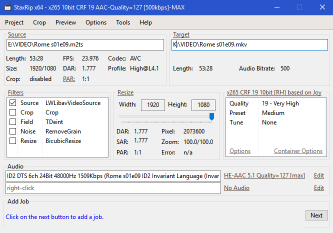

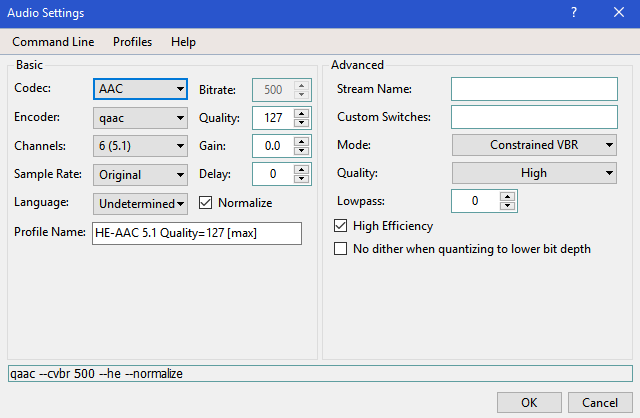

    Has anybody had issues with StaxRip only producing 192Kbps 96 Quality in HE-AAC encoded by QAAC? No matter what settings I give it (ex: Quality 127/Bitrate 500) it will only output 192Kbps 96 Quality.
    Screenshots attached.
    Full log can be found on Pastebin here: http://pastebin.com/i0gRGmT2

  15. I think QAAC simply does not allow more than 192 kbps HE-AAC for 5.1 48kHz audio. (see qaac.exe --formats)
    Mar 2016
    FL, USA
    I disabled High Efficiency mode and it's accepting my bitrate now. I wasn't aware that HE-AAC is mainly for lower bitrates.
