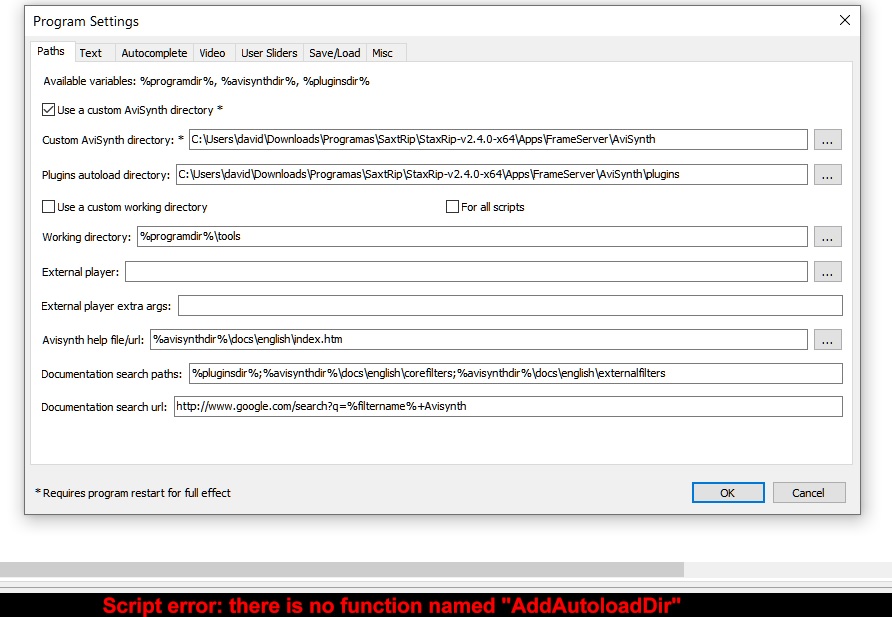

    Hi everyone!! I've started using "StaxRip" recently. I have some doubts I hope you can help me.
    For instance, when I open my script with AvsPMod, this message pops up: There is no function named "AddAutoloadDir"
    I don't know how to fix this error to visualize my script.
    However I don't have any problem when I encode the script.
    Moreover, what script can I use to compare my result with original?
    Thank you very much.

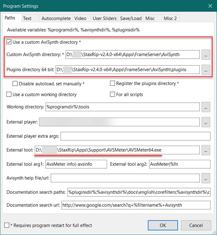

  5. App Digger JKyle's Avatar
    Oct 2018
    StaxRip uses portable AviSynth+ by default while AvsPmod assumes that AviSynth+ is installed in your system.
    Do one of the following.
    In AvsPmod, go to Options > Program settings... and change AviSynth location settings to make use of the portable AviSynth libraries shipped with StaxRip.
    [Attachment 58412 - Click to enlarge]
    Or
    Register the AviSynth libraries shipped with StaxRip to the system by running
    <StaxRip-Folder>\Apps\FrameServer\Install\Install-AviSynth.bat

    I tried to do what you told me, but in my AvsPmod doesn't appear option "External tool"
    [Attachment 58423 - Click to enlarge]
    The second chance, it doesn't work to me either.
