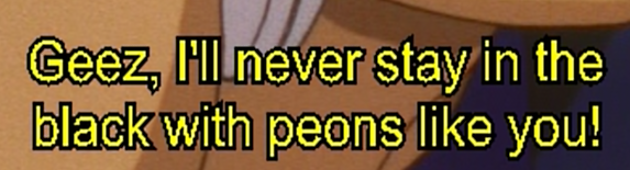

Thing is, they look fine in the preview before I author. Even when I tick the option to show what the subs look like without AA, they look fine. But when I author my DVDs, the subs come out looking terrible, in some sort of ugly font where the letters are randomly disproportionate to what they should be. Typically I pick Arial/Regular/20 as my font, so it shouldn't look that way.
Is there a reason for this? Any possible ways to prevent this from happening?

I'm using the latest version available (2.3 RC1). Here's an example of what I mean:
https://forum.videohelp.com/images/imgfiles/Ut4dfal.png
Notice how some of the letters are randomly disproportionate, like the "L" in "black" and "like." Two completely different sizes, the one in "black" is bigger than the one in "like." Also note the letters "th" in "the" and "with." -
Disable SubtitleCreator's anti flicker filter.
Use an anti-alias color.
And please, for the love of Jesus, do not use Arial. Try "PT Sans Narrow Bold" (free font) or if you don't feel like using that just use Tahoma or Trebuchet MS which are standard fonts you already have. Almost any sans-serif font is better than Arial for subtitling. -
The anti-flicker filter is disabled. I only use plain and fast. Also, I don't think the font is the issue, because like I said, it looks fine in the preview before I author. Arial is also the most standard looking font ever, so it shouldn't look disproportionate like that.

Why are you getting defensive? I'm not ignoring anyone's advice and I never implied that you don't know what you're talking about. I'm sure you're very knowledgeable, however none of the advice I've been given has worked.
I'm not using the anti-flicker filter, like I mentioned. I'm using plain and fast, yet the problem is still occurring. Another piece of advice was to create an anti-aliasing color. I've tried that, and it doesn't help. Picking a different font hasn't helped either.
If the subtitles look fine when I preview them in SC, then what happens during the authoring process that causes them to look completely different? -

Tahoma and Trebuchet were actually the first alternatives I tried, along with the other ones that were suggested. I also googled some other good fonts that are commonly used (Verdana was suggested, but I couldn't find it as an option). Still had uneven lettering in some spots though.
I wouldn't have any problem using different software, it's just that I liked SC for its streamlined process of creating, editing and authoring subs and DVDs. Since I'm relatively new, it made the process significantly easier. What other alternatives would you suggest? -

Your sample screenshot does not show any anti-alias color, so I'm guessing if you did specify an anti-alias in SubtitleCreator the anti-alias color ended up having the same color as the main letter color (or border color) after editing the color lookup table (CLUT) in PgcEdit.Last edited by Skiller; 2nd Feb 2015 at 09:55.
Sorry for bumping the thread, but I thought I should add something.
If I manually add the subtitles to my DVD through method 2 of the SubtitleCreator guide, the font and everything comes out looking fine. It seems as if the issue occurs only when using the DVD authoring wizard in SubtitleCreator.
Strange. -
I have the same problem like you wibikens, i changed the font, the size, everything, same results. I even downgrade to previous version but the result was the same. On CRT TV the subtitle looks fine but on LED TV it looks bad. My solving ? Anyway i wanted just the main movie from the dvd's, so i remuxed in mkv with MakeMKV, the video & audio that i want and the subtitle i left it in .srt and i play it with vlc player. I don't have to make any more .sub file. I think it has to do with the resolution of the .sub file when it's played on LED TV. That's why it looks bad.
