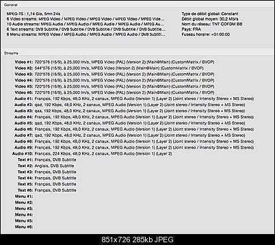

    Post the log?
    And maybe also a mediainfo report from the ts file(view->text in mediainfo).

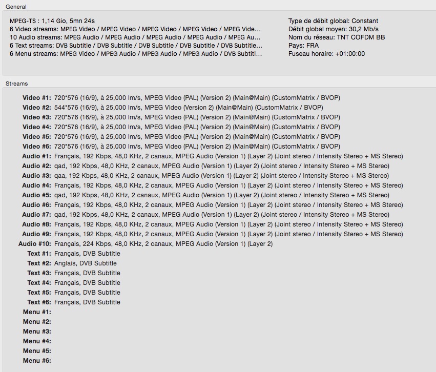

    OK I'll try :
    Mediainfo for input file and log file attached

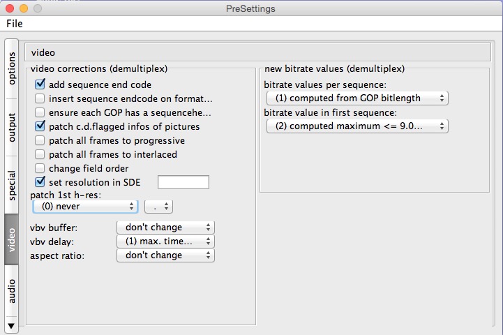

    I had a G4 years ago but I'm afraid I don't remember where the MAC OS puts the ini file, it has to be there somewhere as it contains the selections you make under the Presettings tab. Could you make a screen shot of your Presettings Video tab ?

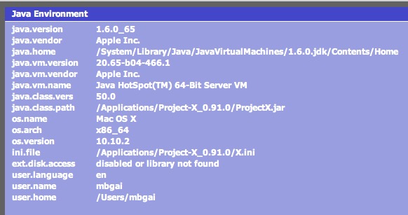

    I just see that, at startup, ProjectX give an "environment panel" into which it gives the X.ini path : just into ProjectX folder ... But unfortunately, I don't see any X.ini file into this folder ? Perhaps X.ini has "invisible status", I am going to search this way..
