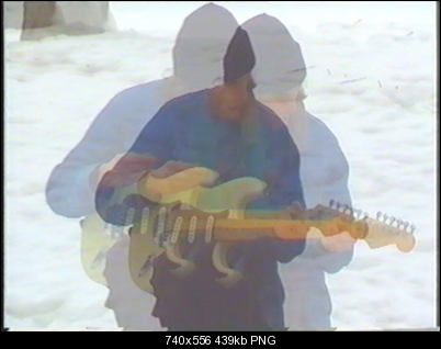

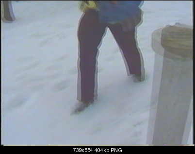

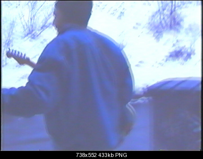

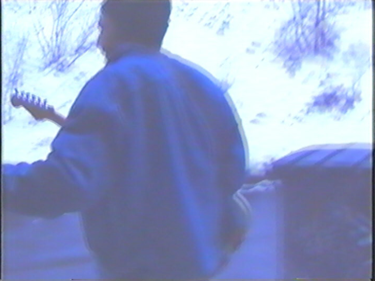

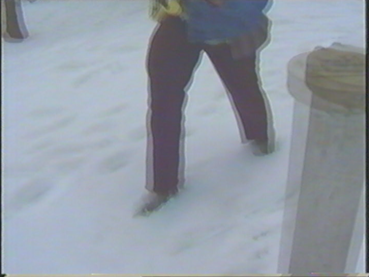

    I'm capturing vhs tapes with my "Roxio Easy Vhs to Dvd" device on MAC. My footage looks fine after capturing it. When i watch it at 25 fps there's no issue at all, I don't have any "lines issue" like most of interlaced footage issue.
    But this is my problem : when i watch it frame by frame and when I pause it on 1 frame that's what i got :
Name:	Capture d’écran 2015-01-29 à 11.11.39.png
ID:	29951Click image for larger version
Name:	Capture d’écran 2015-01-29 à 11.11.20.png

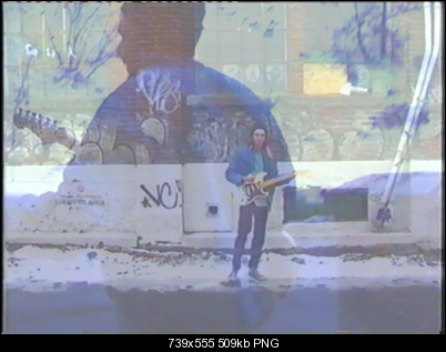

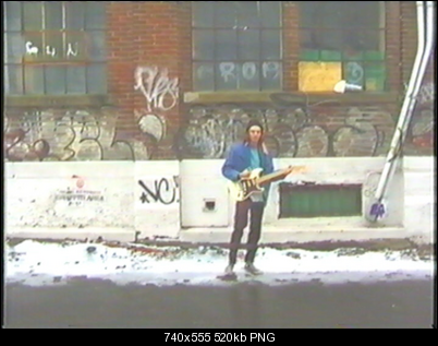

    As you can see, when the subject is in movement, i kinda see 2 frames, blend into each other.

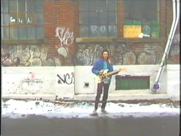

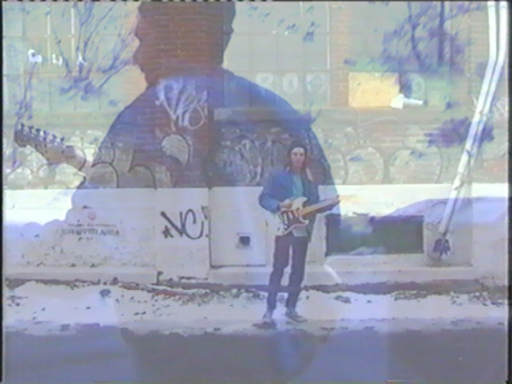

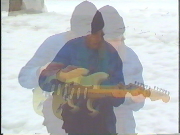

    And the worst is when i pause it on a transition between 2 shots.
Name:	Capture d’écran 2015-01-29 à 11.12.34.png
ID:	29958Click image for larger version

  2. This is outcome of the deinterlace technique called Field blending.
    Or you need to capture without deinterlacing and later perform deinterlacing and perhaps create 50 fps video or keep interlace intact.

  5. Before deciding you need another capture device or software you need to figure out whether the blend deinterlace is happening during capture or during playback. If it's the latter you just need to change the settings in the player.

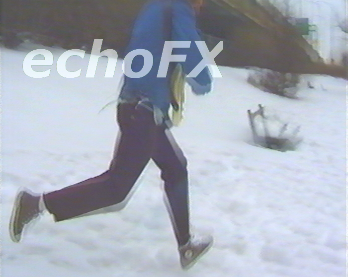

    So i did some test. The issue is the roxio software.
    There's no settings at all ! When you use this software to capture a interlaced video signal, Roxio makes this frame blending thing and you can't do anything about it !

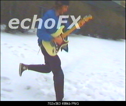

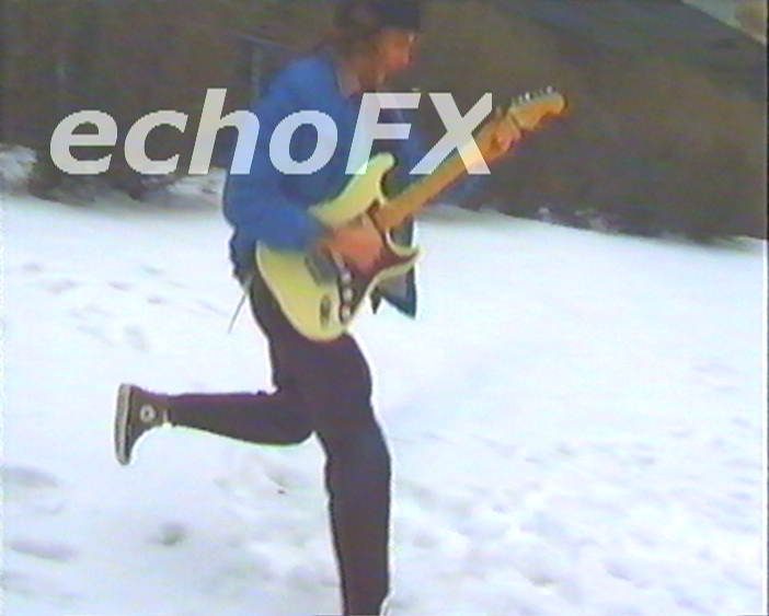

    So I tried Video Glide, and it rocks ! So much settings, so much possibility ! When you capture with it, the software makes you an interlaced video file that looks like that (sorry for the watermark, i didn't buy it yet !)
Name:	Capture d’écran 2015-01-29 * 19.39.44.png

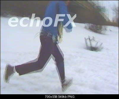

    And after, in Final Cut or Premiere I can completely remove one of the field so it looks much better :
Name:	Capture d’écran 2015-01-29 * 19.40.12.png
    So thanks a lot you guys to help me out with this frame blending thing, i didn't know about that. That's really sad that this Roxio which cost almost 80$ sucks that hard. I mean the software, there's nothing wrong with the hardware.
    Thanks ! Problem solved.

  12. Originally Posted by leromz View Post
    Problem solved.
    Well for me it looks a bit poor - i would go for decent deinterlacing and for 50(60)p (so keep both fields and resolution).
