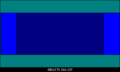

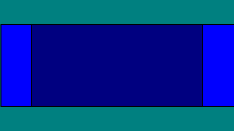

    Below there's a pic to hopefully ensure we're referring to the same thing.
    The entire picture is the same aspect ratio as your TV and the same resolution as Bluray. 1920x1080 (16:9)
    Both the light and dark blue areas are a cinema scope movie encoded onto it.
    The top and bottom green represents the usual black borders.
    The light blue areas left and right represent 250 and 248 pixels respectively.
    The dark blue is what remains of your original 1920x1080 resolution if the black borders are removed and it's cropped to 16:9. Dark blue is 1442x800 (16:9), awaiting resizing up to 1920x1080, or resizing down to 1280x720. I'd probably resize down most of the time in this situation.
    If you feed BDtoAVCHD the light and dark blue areas for encoding (ie a 1920x800 cinema scope MKV), it should automatically add the green. You're then back to 1920x1080 and Bluray compatible. Your borders are back.
    Alternatively, give BDtoAVCHD the whole picture. The original 23GB MKV. Let it re-encode it. Same result, but you've only re-encoded once. Obviously the borders are still there too.
    Depending on how much control BDtoAVCHD gives you (I've never used it) you could give it the whole picture (original larger than 23GB MKV) tell it to remove the green parts, tell it to remove the light blue parts, and tell it to resize the remaining dark blue area to 1080p or 720p and you'd still only be re-encoding once.
    Your current method seems to have involved re-encoding the original larger than 23GB MKV while removing everything except the dark blue (21GB MKV), then you're giving BDtoAVCHD the dark blue part (21GB MKV) to re-encode a second time (while resizing to 1080p or 720p).
